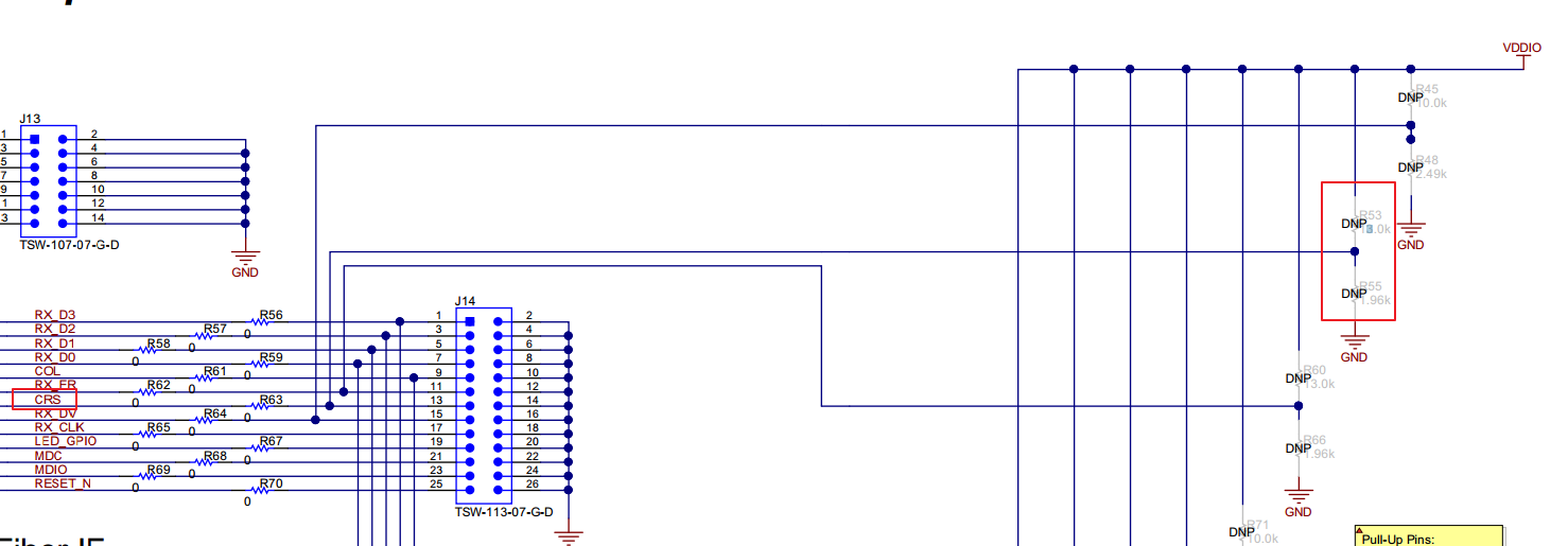

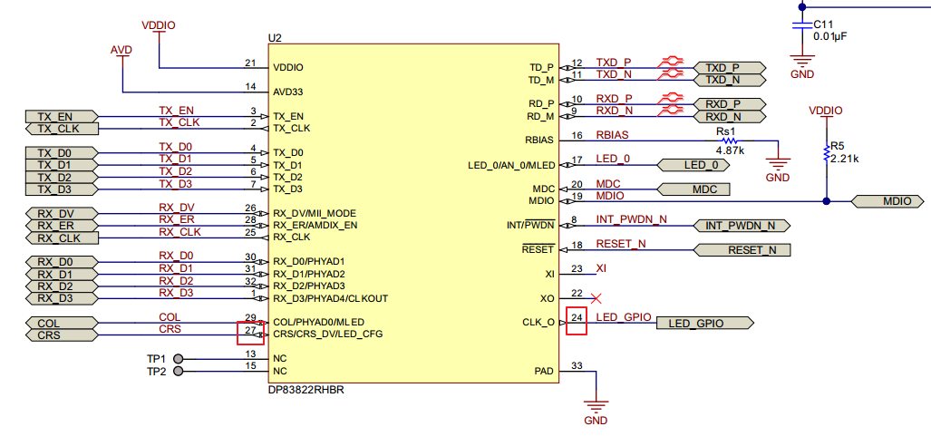

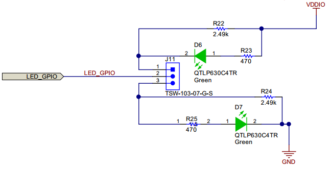

I just  got a DP83822EVM  and want to test the SPEED LED.  I tried to populate the J11 to make the SPEED LED pull up or pull down, but can't  have this LED work. The related LED is D6 or D7.     I also tried to populate the LED_GPIO of J14[connect to gnd], then the SPEED LED keep on, I don't even plug in the RJ45 connector。 My purpose is to test if the SPEED LED is on when connecting to a 100M interface and off when in a 10M network. Please kindly suggest what did I miss or How to do. Thanks.
