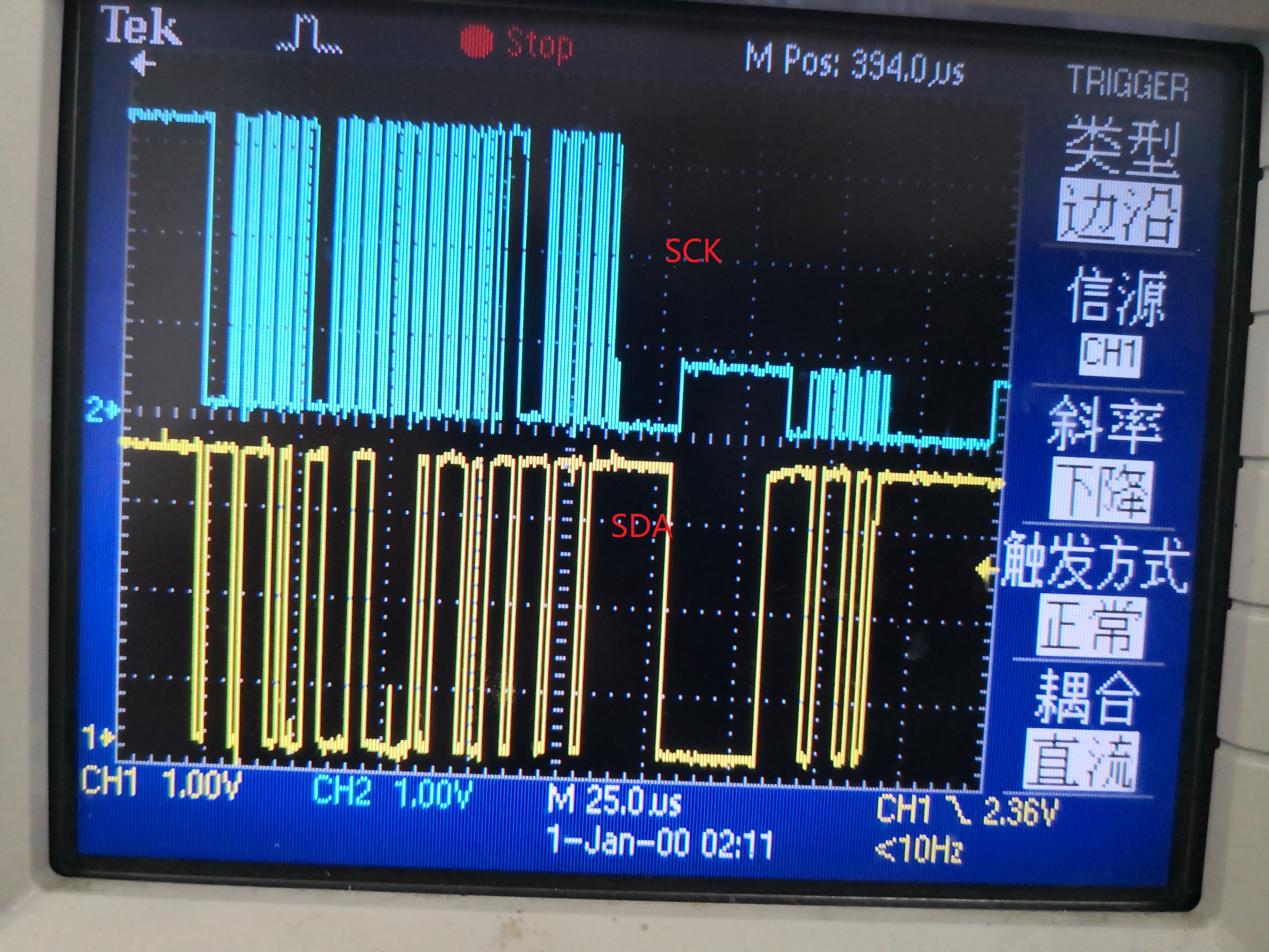

My client USES ds90ub927/928 design, and has encountered some problems at present,they found that DS90UB927's I2C clock signal was abnormal,this is shown below.

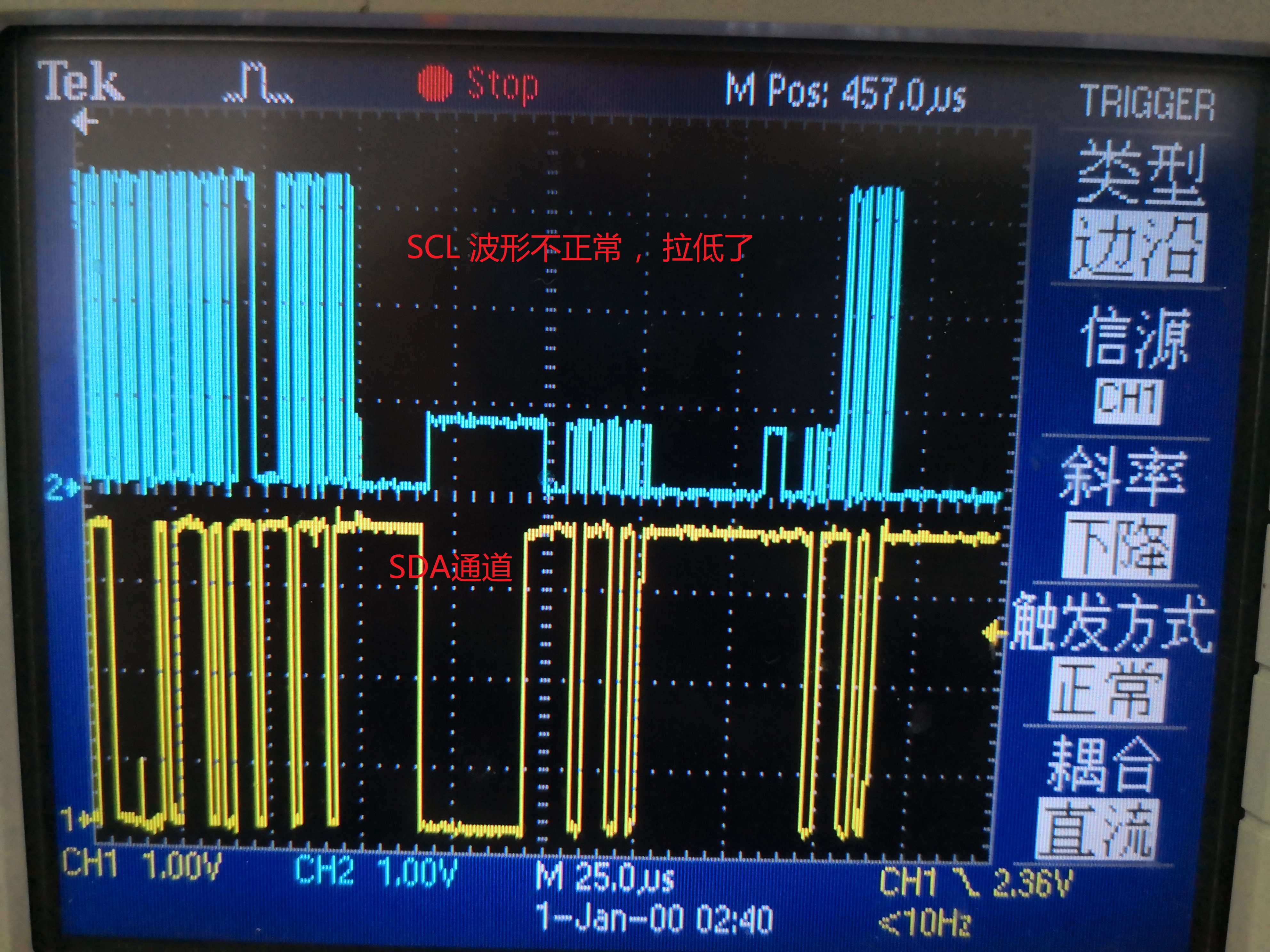

Can i get a little more info on the system?
What is the pull up voltage and what is the pull up resistor value?
Does this happen at random location or follows a pattern?
Is the waveform measured at the 927 input side?

The customer designed a touch screen that USES a 927/928 that displays images but does not respond to touch.
Tests found that when the 928 returned the signal, the I2C clock signal was pulled down,The clock comes from the ARM next to the 927 chip, and the I2C is standard hardware I2C.
It is pulled down exactly when it is 928 ACK, the ninth digit of the clock,when the clock is pulled down, the data can't be transferred, and the screen on the 928 is not touched
Could you check if the I2C master supports clock stretching?
What is the pull up resistor value?
Charley Cai
Hi
This problem has been solved. It is found that the problem is not TI, but MTK does not allow external devices to lower his clock
