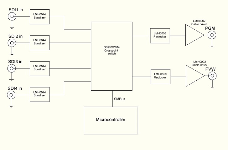

Hello! I want to design and build a small HD-SDI video switcher for four inputs and two outputs with both PGM and PVW buses and one type of transition - CUT. Is it possible to use the built-in multiplexer LMH0056 for seamless switching of HD-SDI signals with switching quality as cut in vision mixers? Or, for example, apply the crosspoint switch chip DS25CP104A together with the LMH0056 reclocker?
