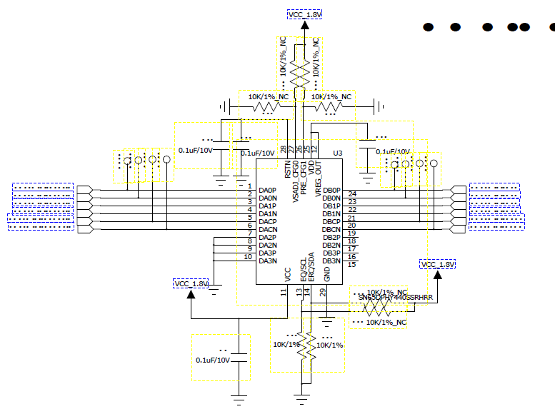

My customer is designing the SN65DPHY440SS schematic. Please see below picture. I already checked it and didn't find anything wrong. But hope you could also double check on it. Thanks.

Lane 0 is a special lane. DPHY440’s lane 0 is the only lane that supports the back channel. For this reason, DPHY440 lane 0 must always be connected to lane 0 of GPU and panel. If you don't plan to support the back channel communication, I would recommend connect to lane 1 and lane 2, and have lane 0 and 3 connected to ground.

Customer doesn't need the back channel function on Lane 0. But they have finished the PCB design so I just want to check with you that will Lane 0 have any bad impact on the normal communication function? Can they keep the current design? Is there any risk here? Thanks.

It depends on their application and this is why I recommend not to use lane 0 to avoid any potential issues.
If there is an issue, we do have SW workaround to work around the issue.
