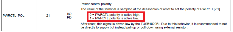

Hi Team,
TUSB4020BI (2 port USB2.0 Hub) datasheet shows the follwoing.
On the other hand, TUSB4041I (4 port USB2.0 Hub) datasheet shows the folowing.
It is opposite logic between TUSB4020BI and TUSB4041I.
Is it true?
I would like to aks if the description is typo or not.
