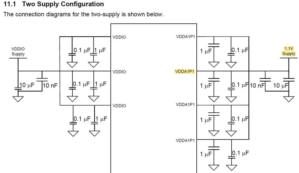

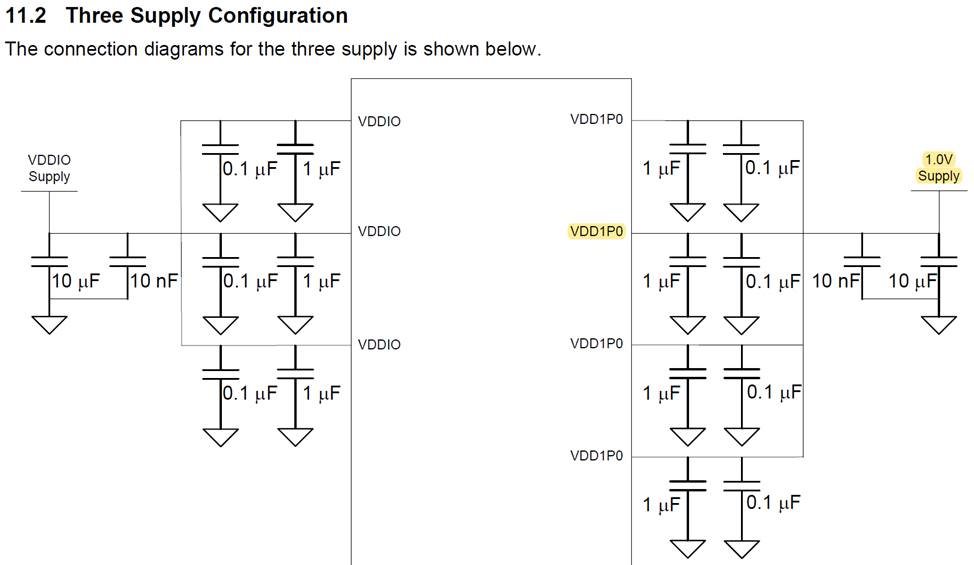

Customers are confused about the power supply of the VDDA1P1. In section 11 of DP83869 datasheet, the power supply for VDDA is different(Page109 and Page111), and you can check it from below screenshots. And customer wants to know which voltage level of VDDA he should use (1.0V or 1.1V).
