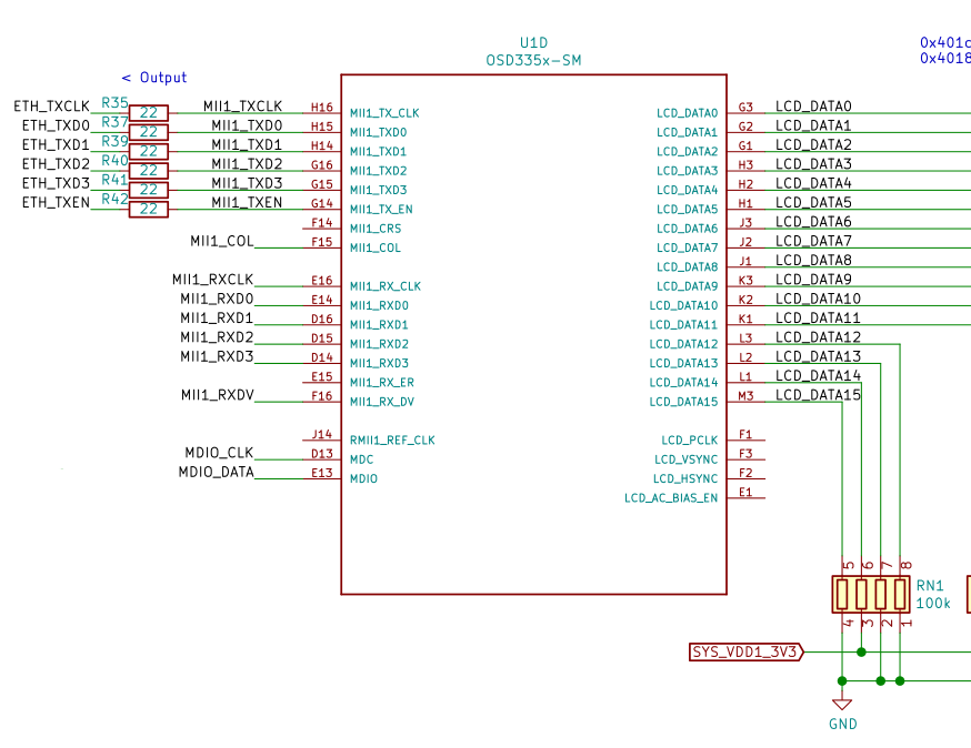

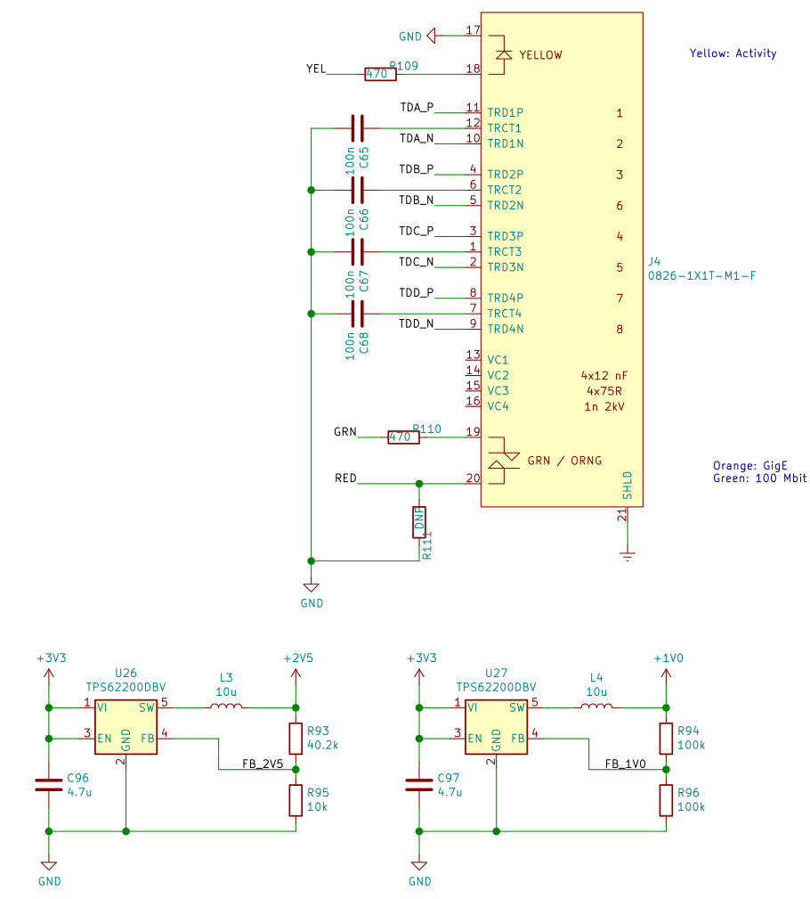

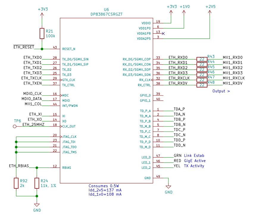

Hardware Information
- PCB: Custom design, using Octavo Systems reference for OSD3358-SM
- Ethernet Phy: DP83867CS in 3-supply mode (3V3, 2V5, 1V0) referencing TIDA-00204. No strap resistors, everything left open.
- Linux Kernel: 4.14.108-ti-r108 (hand compiled), 4.14.71-ti-r80 (Beaglebone stock), and 4.19.50-ti-r20 (RCNEE Repos)
- Stock device tree blob (for now, custom blobs don't do much.)
Issue
Both Linux and U-Boot can identify and interact with the PHY through MDIO -- though Linux does not correctly identify the driver, which is installed as a kernel module. The device can establish a link at 1 Gig, base 100, and base 10, which I forced thru mii-tool. The data and link lights also illuminate on the jack, which correspond to link establishment. Reading the registers, everything seems to be nominal and accurate per the datasheet. However, it seems no traffic goes in or out of the device. I've experimented with various device tree settings, but what concerns me is it appears the device has not received a single packet. On the other side, I've looked at wireshark, and see no packets either. Neither DHCP nor static settings work in u-boot, or in Linux. I have yet to probe the ethernet pins with an oscilloscope to check for output, or the RGMII interface to check for clock skew -- hopefully I will have that taken care of tomorrow.
