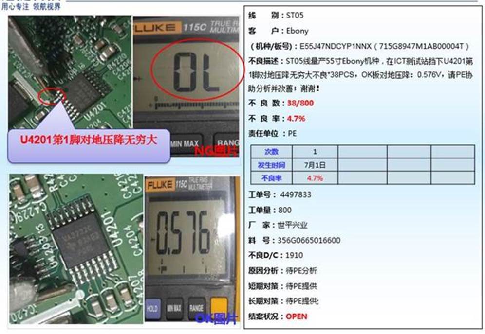

My customer is wondering what is the function of C1 to C4, and how to know if those pin are working fine?
Can you help to let us know the internal configuration of these circuit?
What should we see on the pin1 to pin 6?
