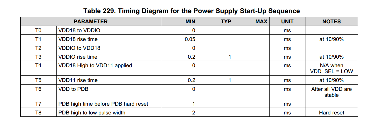

Could you please explain the meaning of T0 and T2? Tvdd18-Tvddio>=0, Tvddio-Tvdd18>=0, does that mean VDD18 and VDDIO should be powered up at the same time?

It does not matter if VDD18 is powered before or after VDDIO. Both cases are okay.
