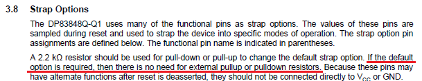

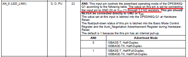

Hi Team,
The datasheet shows the following.
On the other hand, it seems the following shows external 2.2kΩ pull-up is required to set high.
Which is correct?
Is external 2.2kΩ pull-up is required to set high (default) for AN0 pin?
