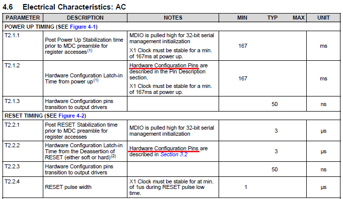

The following shows description of "Hardware Configuration Pins".
Could you clarify which pins are "Hardware Configuration Pins"?
Is AN0 pin "Hardware Configuration Pin"?
