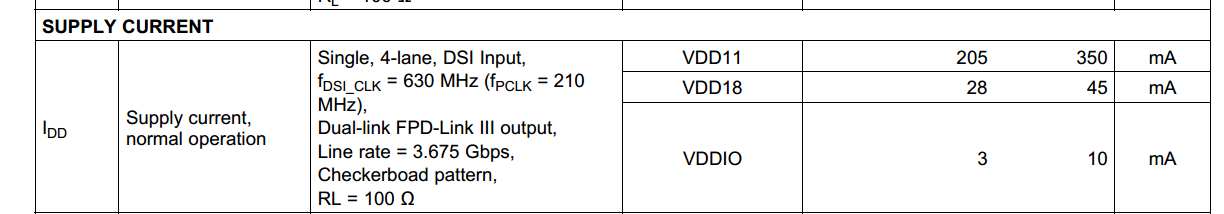

What's the maximum current for each rail if 941 operates in dual DSI input mode?
Part Number: DS90UB941AS-Q1
For dual mode you can expect the following current consumption:
1.1V -> ~ 205mA
1.8V -> ~ 62mA
VDDIO -> ~ 3mA
