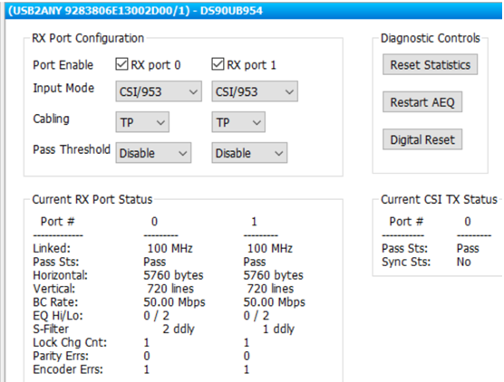

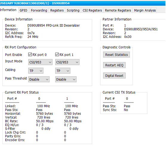

When I used vender1 3.5m wire, it works well above 60 hours at about 25°C and there is no any errors. Picture as below
And the margin analysis of port0/1 as below, it seems well.
But when I use vendor2 3.5m wire, it run about 12hours at about 25°C,and there are 2 encoder erros of port0 and port1. Picture as below.

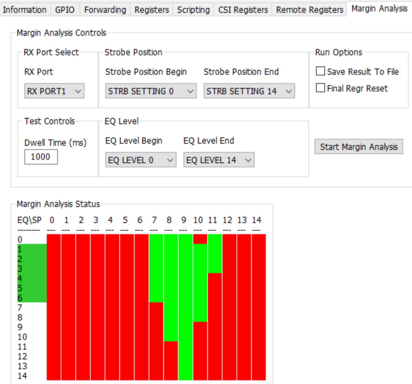

The margin test of port0 and port1

    1. Look at the MAP tool data, the pass criteria is 3 EQ levels and 4 strobe positions. From what you have shared, the link should pass.

    When I use the ALP "Current RX Port Status" to test my device, it can works well using 3.5m STP wire at about 25°C,but it will be lock changed and encoder errors at about 60°C. The thermal design seems well, Tj of 953/954 and other power ICs will be not exceed 80°C.

    At 72 hours of test @ 25C, I get no lock change, no error.
    First, connect the I2C interface of USB2ANY to the I2C of 954, open the ALP software and start the device to ensure that our device can produce images normally.There will be lock change and error in the first startup, and the error will be cleared after the system is stable.Continuously observe whether lock change and error occur during the operation.In the previous test, I used 3.5m cables of three different brands, and there was no error. Of course, some manufacturers also failed the test.
    However, when the high/low temperature test was carried out, none of the cables from these three manufacturers passed the test.

    I take Margin test at high and low temperature, which looks good, as shown in the figure below
    So, you think my test method is correct? In your opinion, does Dacar535 wire with a length of 3.5 meters meet the attenuation demand? We have test the loss @about 25C, it is no problem.

    Just another thought I had. Can you do the margin analysis at the 3 temperatures: low, high, and 25C? Then from there you can observe what are the optimal EQ and Strobe Position settings for each temperature scenario to manually program.
    However, keep in mind, in normal operation TI does not recommend manually controlling the EQ and Strobe Position -- this is simply for characterizing the system and debug. So if the device can't automatically compensate for any temperature variation, you're still in the same situation but at least you can identify what's causing the failure a bit more.
