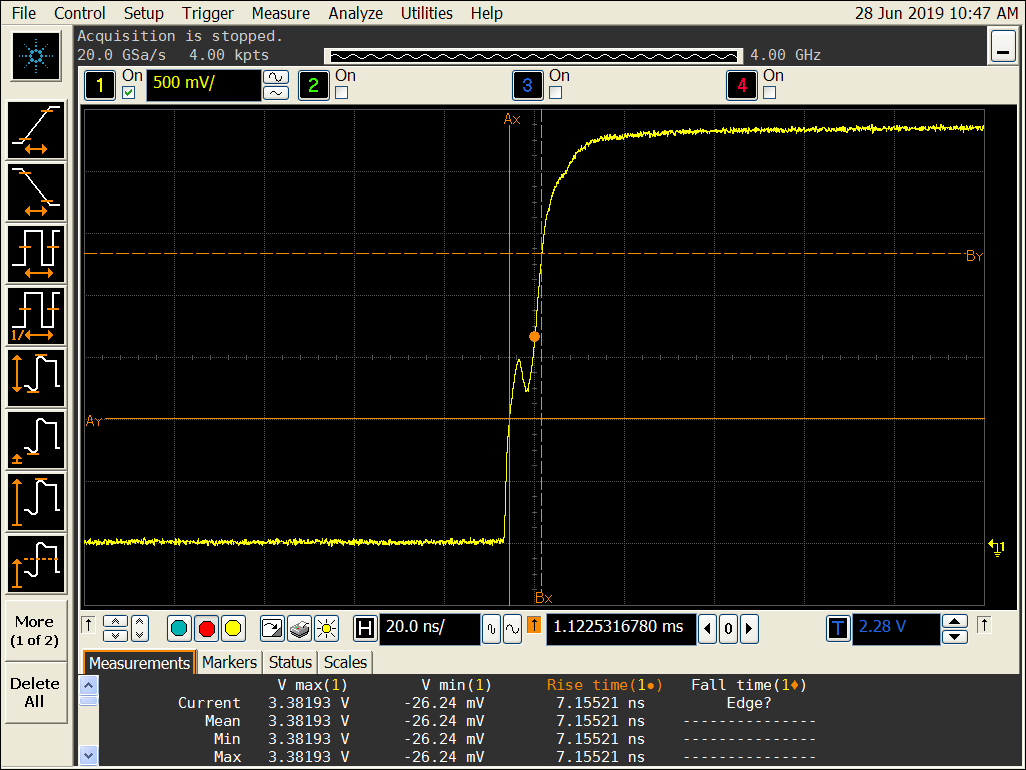

i'm looking into datasheet of TCA9617B & still determining if this device is suitable for my system and I have questions which needs verfication.
Does TCA9617B carry built-in Schmitt Trigger on it's input pins?
In my use case I'm having a non-monotonic I2C clock and data signal inbound and i'm concerned if this might cause double-triggering in my system.
Also if there's indeed schmitt triggers on the input pin, what are the V+(Upper Trip Point) and V-(Lower Trip Point) ?

  • Hi Bobby,
    I'm attaching a screenshot whereby client probed at the TCA9617B's A side.  They are non-monotonic edge at the falling edge. Does the V-, V+ for the falling edge are also same as the V- and V+ for rising edge?
    I re-attach the rising and falling edge of the I2C clock signal (probed at A side) below. Could you please advise would the observed non-monotonic edge potentially cause false triggering?

  • Hey Leo,
    The rising and falling V+ V- thresholds are the same.
    "I re-attach the rising and falling edge of the I2C clock signal (probed at A side) below. Could you please advise would the observed non-monotonic edge potentially cause false triggering?"
    The width of the glitch looks incredibly small, sub 5ns? That likely isn't enough time for the logic to propagate through our device. The glitch is smaller than ~5% of the propagation delay from A to B side.
    I don't think that's enough time for the input stage's FETs to turn on in time even if it was at the hysteresis +/- values.
