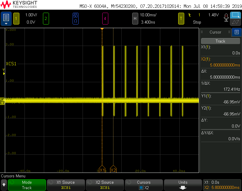

Hello everyone,
I am desperately trying to make two DP83822I work. They are both connected in RMII to one NXP i.MX6ULG2 and have the addresses 0x00 and 0x01. For the schematics, please contact me in private.
The MDIO interface seems to work fine, I can read all the registers and their reading seem OK. The PHYs are configured in RMII and are slave. The 50MHz is well sent from the CPU.
Nevertheless, auto-negotiation fails nearly all the time and I have no link (no led turned-on and no ping possible in u-boot).
By looking at the signals, I see that the pulses I have for the negotiation a duration of ~40ns instead of 100ns and are repeated every 5.7ms instead of 16ms. It looks like the PHYs work in free-running mode (at 125MHz ?) but I don't know why that would happen.
Here is a dump of the main registers (connected to an empty interface but similar values when connected to the network).

The overall shape of the pulse is good but the timing is wrong.
Is there anything I could check to fix this issue ?

  • Hi Sébastien,
    This can be due to any of the following:
    - Glitch on the power supply ramp
    - Glitch on Reset pulse
    - Un-optimized board layout causing noise coupling on the supply pins
    - Un-optimized 50MHz clock routing
    What is your VDDIO level? Can you read register 0x0421?
    Hung Nguyen
    Thank you for your reply and sorry for my late answer, I was trying to get as much information as I could.
    So, about the layouts, I am pretty convinced that everything is fine. All the lines are routed with an impedance of 50ohm and length matched. The PHYs are really close to the CPU (~1cm) so it should not matter anyway.
    The VDDIO level is 3V3. About 0x0421, what I am supposed to find there ? (not documented). Is is part of the extended set or not ?
    For the reset and the supply, there was some interesting data. The reset is not well performed on my board. The 50MHz clock is provided to the PHYs (XI) by the CPU. The CPU and the PHYs have the exact same reset signal, so the XI is not present when the reset goes high. I changed that but it didn't help so much.
    About the ramp-up, the supplies are fine but I measured my 3.3V/Reset pin at 0.8V with an power supply OFF on my board!
    In fact, I have a FTDI cable connected to my board which injects current/voltage to the whole system when it's off via RX and TX. There was the culprit. If I remove the FTDI cable at startup, everything starts properly. If it's there at startup, PHYs are not properly working. I tried to sink current on my 3.3V supply and it starts to work with a "0V" state of 550mV.
    So, it is OK now, the problem was not really linked to the PHYs (I guess there are more sensitive that other chips which work with the exact same voltage issue).
