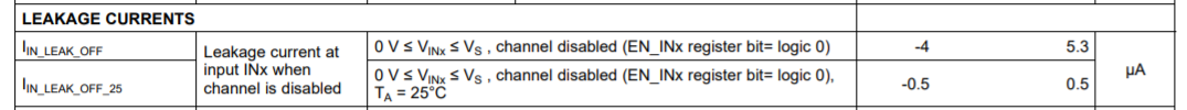

In the sleep mode, we will ask for the leakage current value when the switch input is ON.
In case of Sleep mode in Switch On state, Leakage current is high and it needs confirmation.

Hi, Youngsu,
When the TIC10024-Q1 is put into the sleep mode (polling mode) and when the input is not getting sampled, the leakage current for each input is the same as if the channel is disabled and it's spec'ed in the datasheet as below. The leakage current is specified regardless of whether the external switch input is ON of OFF as it is only a function of the voltage on the VINX pin and the temperature.

We encounter the following phenomenon.
1. INx : S/W ON (GND)
2. Idle state
3. 60 ~ 80uA current per channel is confirmed (current increases as channel increases)
In the above conditions, it is necessary to confirm whether or not the setting is wrong.
Can you confirm the settings to reduce the current under the above condition?
Thanks.
