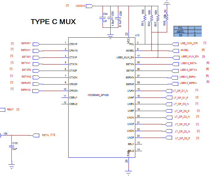

Part Number: HD3SS460
1. What is the intended application?
2. Do you have AC coupling caps?
3. Please refer to table 1 of the HD3SS460 datasheet, are you driving POL, AMSEL, and USB_MUX_EN signal?
4. How does the SBU1/2 being connected in your design?
