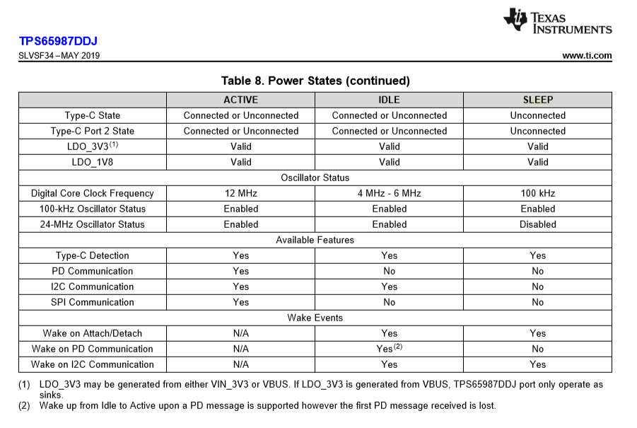

We're designing notebook using TPS65987DDJ,
and we want to reduce its power consumption, when there's no USB-C device attached.
So we need to make TPS65987DDJ sleep as often as possible.
and TPS65987DDJ state should be
- 0x20: 05
- 0x70: 05
regardless of notebook state (S0 / S3 Sleep / S4 Hib / S5 OFF)
Is our understanding right ?
