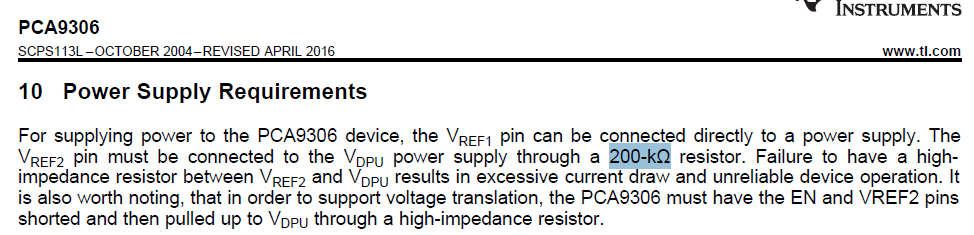

Part Number: PCA9306
Hi TI:
I saw there had the below description in the TI PCA9306 datasheet, it required a 200k ohm pull-up resistor between the Vdpu and Vref2/En, must the resistor be 200k for 3.3V/2.5V? what is the reason of  this value for this resistor, not other value? Would you please share some information for this resistor? Thanks.
