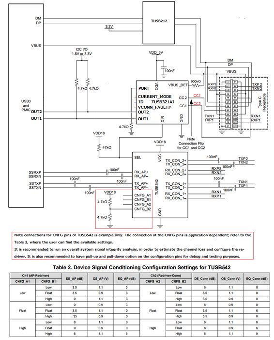

TUSB321AI: Schematic review for UFP-only
Part Number: TUSB321AI
Could you review the schematic for UFP-only?
