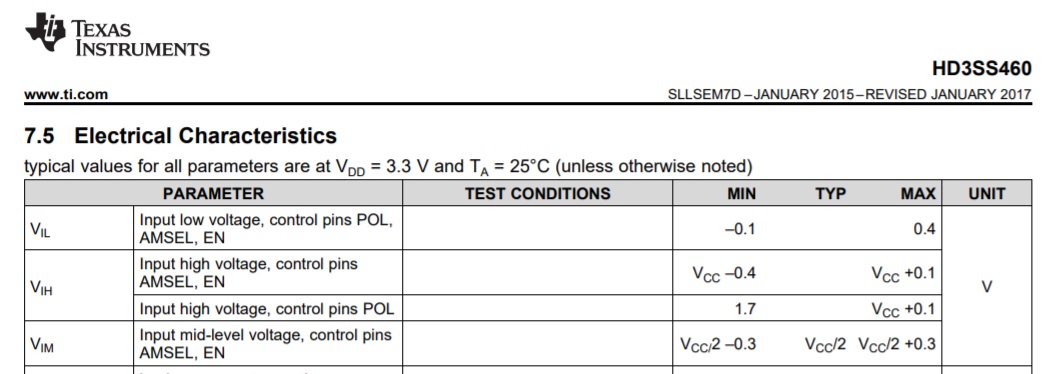

In my customer, we are using TPS65987D together with HD3SS460 and set I/O config for AMSEL Event.
Question: Do this GPIO (using GPIO0) AMSEL Event supports HD3SS460 VIL, VIH and VIM voltage levels shown below?
The issue is that we measured AMSEL voltage to be 1.1V for VIM (mid level) when VCC = 3V. It should be 1.2V (min). GPIO0 (AMSEL) is connected directly to AMSEL pin of HD3SS460.
Thanks.
Gim Song
