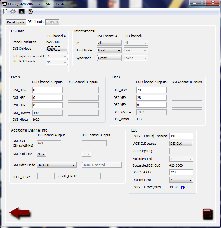

We are using a custom board which has MIPI DSI to LVDS bridge (SN65DSI84) to give LVDS display.
We need to bring up a dual channel LVDS display (G133HAN01.0 AUO). LVDS panel pixelclock ranges from 134 MHZ to 149 MHZ.
We have configured panel inputs and DSI inputs according to the datasheet to generate the CSR values. But we are getting a warning message "DSICLK RATE SHOULD BE LESS THAN 500M"  even though the DSI clock rate is 423 MHZ.
Attached the pictures of DSI tuner configurations for your reference.

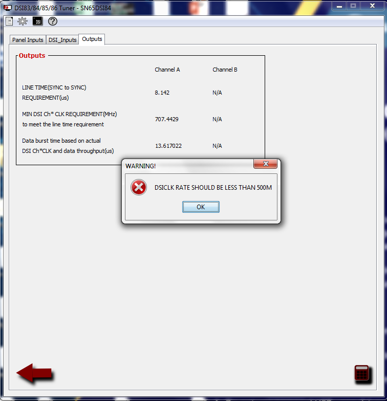

  1. Is our configurations are correct ?
  2. Can we skip this warning message ?
  3. How can we overcome this warning message ?
Please provide your feedback.
Antony
  • Hi Antony,
    This is because your configuration calls for a 707 MHz DSI CLK rate to source the LVDS CLK frequency you specified and to  ensure the line time is the same on the DSI side and the LVDS side. Your configuration is not correct. Your LVDS panel probably has two clock inputs, which means the LVDS clock frequency should be half of what you specified.
    Please reference this video to understand how to configure the device correctly: https://training.ti.com/configuring-sn65dsi8x-single-channel-dsi-dual-link-lvds-operation
    I.K.

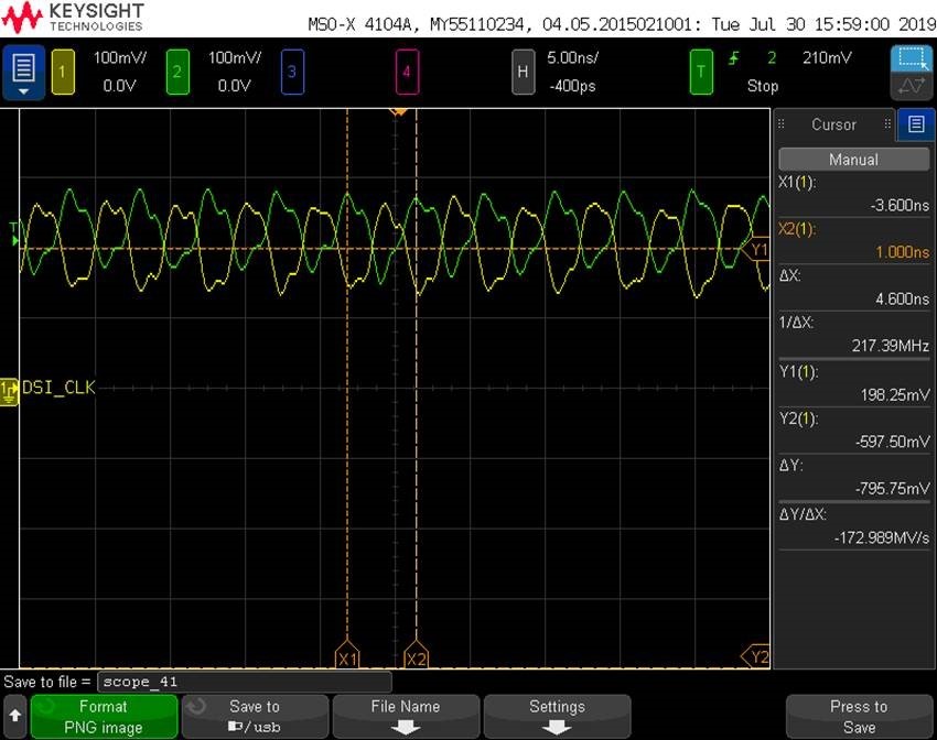

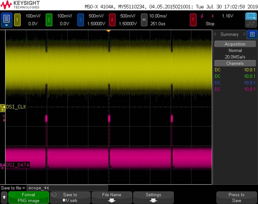

  • Antony,
    Please post an oscilloscope screenshot of your initialization sequence. It should look like the below:
    Also, when I said make sure that your DSI CLK is continuous, and stays in HS mode the entire time after initialization, I mean you should ensure that it does not return to LP11 mode after the initialization, and remains in HS. Is this the case?
    I.K.
  • Hi I.K,
    We have measured our initialization sequence. Please see below and provide your feedback.
    LVDS single channel : EN to DSI_DATA about 750ms (Bring up normally)
    LVDS dual channel : EN to DSI_DATA about 1500ms(Bring up abnormally)

    We have probed MIPI DSI signals coming out imx8m processor. From DSI tuner, suggested DSI clock is 222 MZH and DSI Ch A clock is 444 MHZ. CSR register 0x12 value is  0x58.
    Below is our oscilloscope screenshot showing DSI clock as 218 MHZ. But we are expecting 444 MHZ.
    DSI Clock frequency : 218MHz
    DSI data activity
    Please provide your feedback on DSI clock.
    Why it is showing 218 MHZ instead of 444 MHZ?
    Antony
  • It's probably an issue with your processor, which is something you'd have to ask an NXP engineer for assistance with. The DSI84 does not control what is output from the processor.
