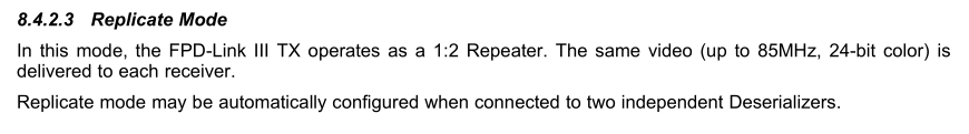

I learned from the datasheet that 947 has a Replicate Mode as below,
Please help evaluate if the following solution is feasible? If not, what are the precautions?
The SOC outputs a 10-line LVDS signal to 947,and 947 converts it into two FPD-Link III signals, driving two screens (924). The two screens display exactly the same content.

  • Hello Sherry,
    Yes this is possible. Just you need to make sure that the source is using 1x clock pair (not both) and the PCLK can be max 85MHz.
