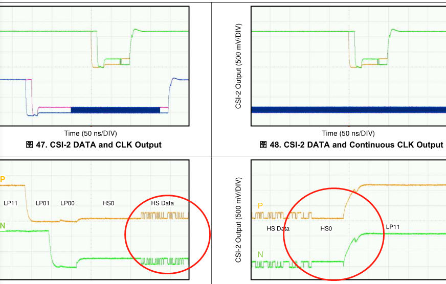

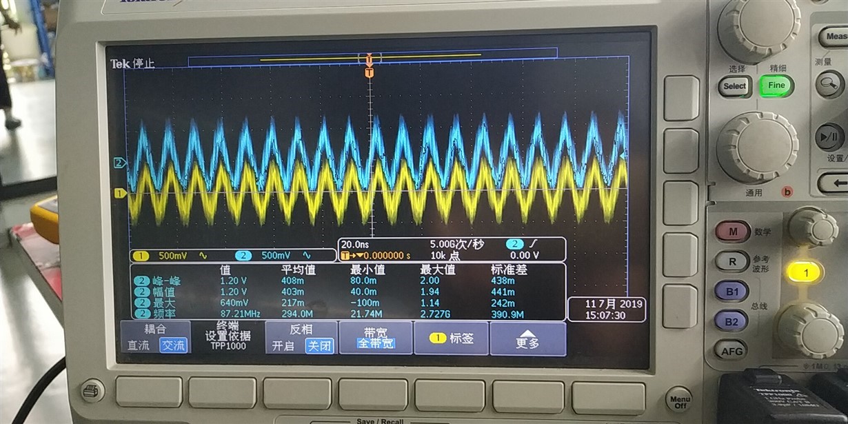

The waveform of CSI output is inconsistent with the datasheet. The measured clock and data waveforms are as follows:
Customers need the following support:
1. Confirm whether there is any problem with the configuration of CSI end and port and whether there is a lack of configuration. If there are any questions, help me point out and revise them.
2. Is the measured waveform normal?
  • Hello Amy,
    The scope and probe being used to measure the CSI signals does not seem appropriate for the speed. If you are using continuous clock mode you can probe the clock deferentially, but you need a much higher speed scope/probe since the waveform looks very distorted. I would suggest at least a 2GHz-4GHz scope/probe for these signals.
    For the data, in order to match the waveform in the datasheet, you must probe the P/N signals of one of the data lanes with each one single-ended to GND. This is because DPHY uses dynamic terminations, so the signals switch between single ended and differential periodically.
