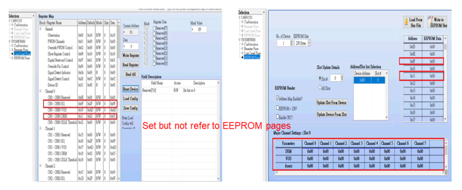

customer would like do configurations setup to EEPROM file by sigcon tool.
the issue is that changing the setting in "low level page" but the setting does not able to mapping to EEPROM pages.
Can team teach how to do the setting to EEPROM file build up?
  • Hi Peter,
    To make updates from the "Low Level Page" appear in the "EEPROM Page" you should only have to click on the "Update Slot from Device" button.  It is also possible to make changes on the EEPROM side and push them back to the register page by clicking the "Update Device from Slot" button.
