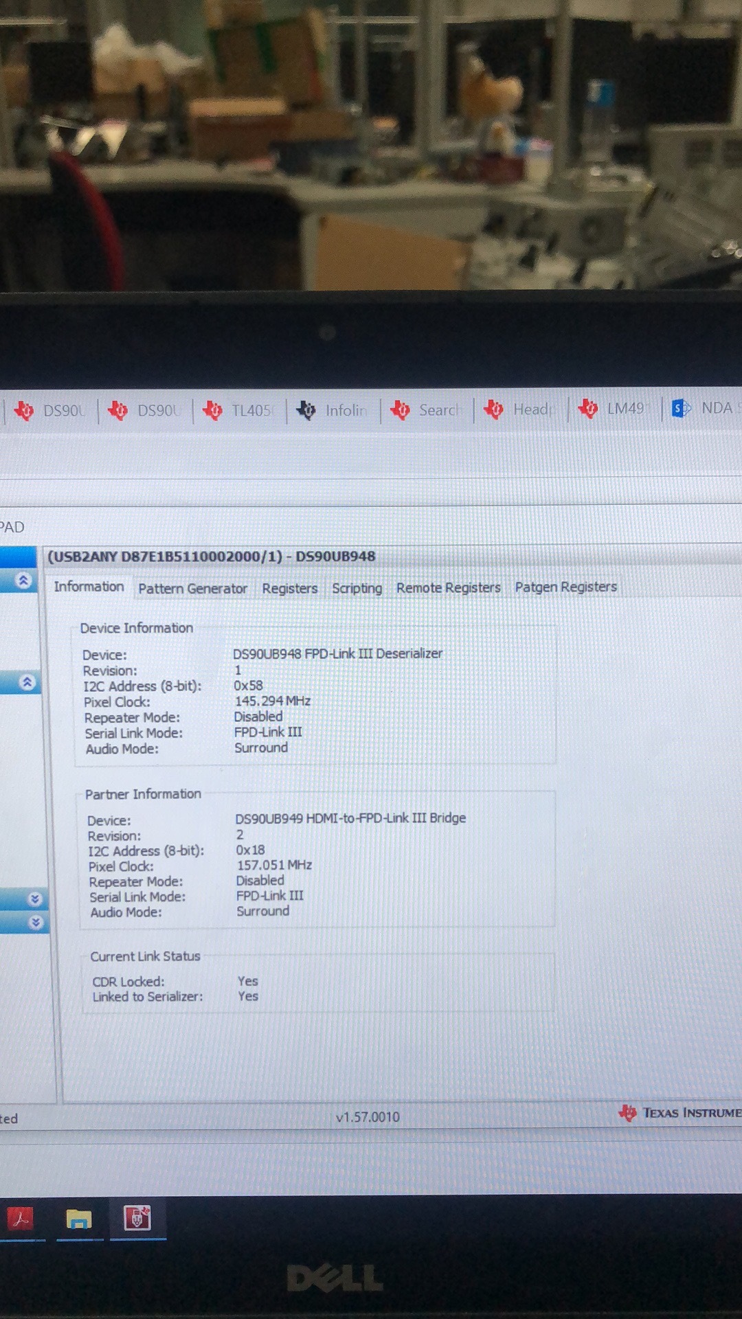

My customer wants to use MAP tool, but we can't connect successfully. The computer connects the one side of the USB2ANY, and USB2ANY's other side connects the DS90UB948-Q1, and DS90UB948-Q1 connect the DS90UB949-Q1 through the cable as below the first picture. But the computer always show no detection as below the second picture.
Could you please tell me the reason? Do you have any documents to introduce how to set up the device?

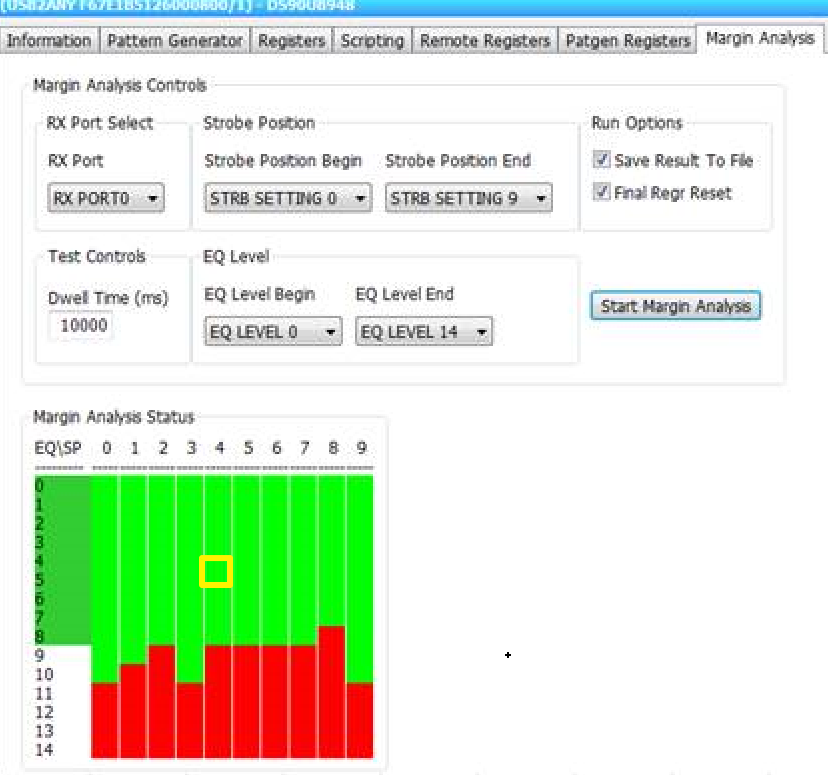

    1.The USB2ANY tool is connected to the IIC communication line of the deserialization chip (hereinafter 948 is an example). What is the connection sequence? Should I connect USB2ANY first and then power on the 948 to initialize(method 1), or disconnect the IIC communication after the onboard MCU completes the 948 initialization through IIC communication, and then connect with the USB2ANY IIC(method 2)? The two connection methods have different simulation results. The first picture is method 1, and the second picture is method 2. Which one is correct?

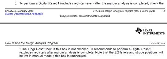

    4. I don't quite understand the following instructions for Final Regr Reset. How is the Reset0 operation implemented? If the Final Regr Reset dialog box is selected, is all register values reset to the original values, regardless of whether the register values were manually modified multiple times before?

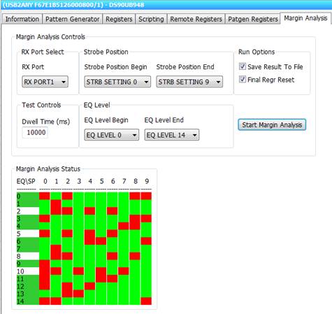

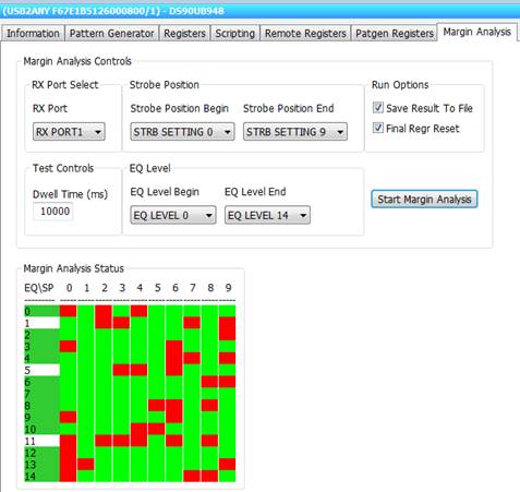

    7. Regarding the output result of MAP, under the same SETUP (physical connection and ALP setting) conditions, the results obtained by multiple simulations are inconsistent. Is there any link missing or wrong?  same setup, the first picture is the first test result, and the second picture is the second test result.

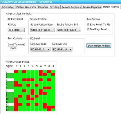

    9. The 948 has two input simulations, which get different EQ/SP OK settings, and are not completely related. How to choose the appropriate EQ/SP settings and meet the requirements of both LANEs?  The first picture is RIN0, and RIN0 can select EQ=9/10/11,SP=6/7/8/9. The second picture is RIN1 which is different from the RIN0.

  • 1. Method 2 is correct

    4.If final register reset option selected, after running margin analysis a digital reset (including registers) of the device is done. Value 0x02 is written to Ux948 device register 0x01.

    7.Method 2 should give you consistent results. When sweeping, the margin analysis program is repeatedly modifying the SERDES registers and monitoring for lock and status bits. So disable any SOC access or setup.
    8. Red box indicates loss of lock or errors. After the selected dwell time, lock and errors are repeatedly monitored. If there is no failure (10/10) you get a green box. If it fails 9/10 times, you get red (in the saved file 0.9) and so on.

  • I checked about Q9. Device has AEQ controls per port. So basically registers are duplicated for each port. Please refer DS90UH948-Q1 Data Sheet Section 8.3.3. If PORT1_SEL in register 0x34 is set, port 1 AEQ controls are selected.

    Yes, I see the SNLA301, page 8, but I still don't know how to choose fixed EQ/SP value. Below picture the green area is too large, and I don't know how to choose the appropriate fixed value. You mean I need to choose the center value, so the appropriate value is the value marked by the yellow box below, right?
    Thanks & Best Regards,
    Sherry
  • Sherry
           Suggest you choose AEQ. AEQ completion and completion of adaptation of the overall system is indicated by LOCK signal going up. AEQ is always adapting, especially to changing conditions in a car.
