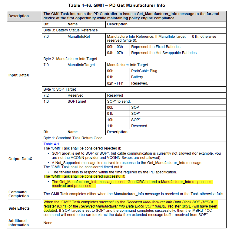

    Do you have a PD analyzer that you can use the read the PD communication being sent between the two devices? You want to make sure that the Get_manufacturer_Info and Manufacturer_Info messages are sent between the two devices. Also, another register that will contain the manufacturer info is 0x7E.

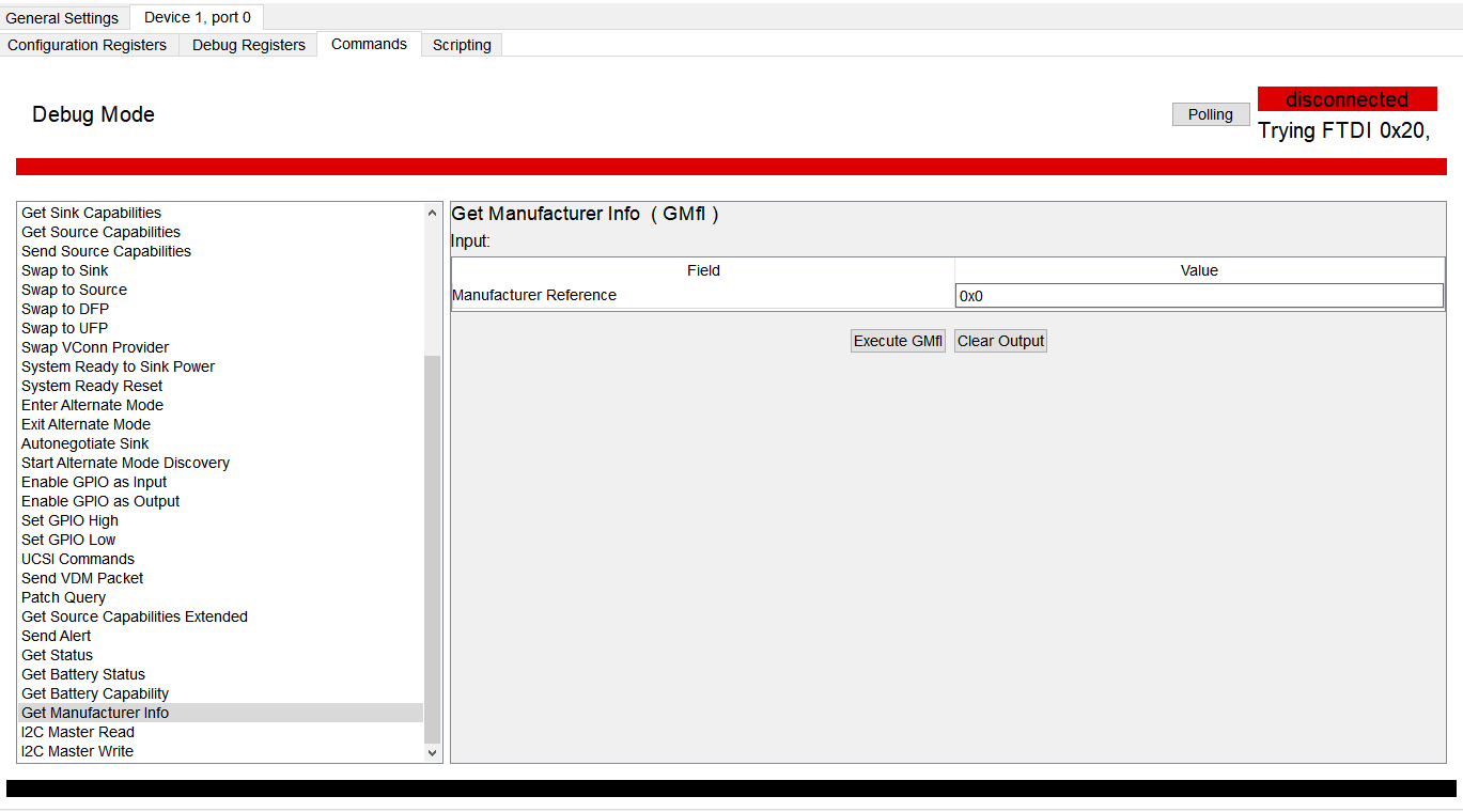

    If these messages are not being sent, or you still do not see anything in register 0x7E, you can issue the 'GMfl' command (Get Manufacturer Info). This is done by going into to debug mode, clicking Device 1 port 0, click commands, and scroll to the bottom for Get Manufacturer Info. Then click "execute GMfl" and the Get_Manufacturer_Info message is sent from the PD controller that is currently in debug mode.

    (The GMfI command says, when I connect two Boards, "ABORT_CMD" or "REJECT_CMD".)
    Edit: Now on the powering board it shows "SUCCESS_CMD", too but reading the registers still shows zeros.
    When one Board is connected to a power supply which has written IDs, GMfI says "SUCCESS_CMD" but the registers 0x71 and 0x7E are still all zero.

    One reason why you are seeing the REJECT_CMD is that the PD controller sending this message must be the one providing VCONN.

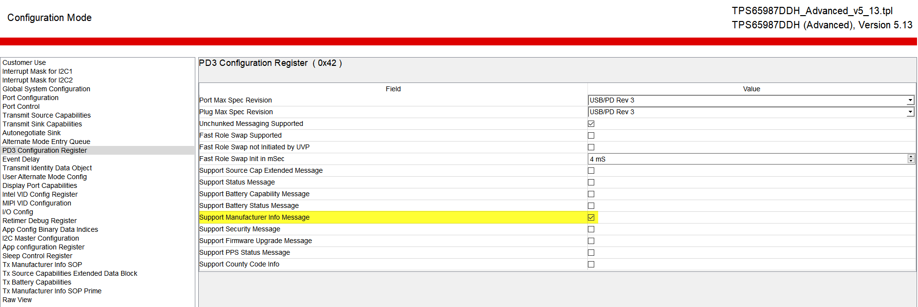

    As far as why register 0x71 is not being updated, I think I figured it out. You'll need to update the configuration of both devices to where the manufacturer info message is supported within register 0x41. Just tested this on my end, and after enabling this bit, sending the GMfl command, register 0x71 is successfully updated.
  • Hello Adam,
    Thank you, now everything works just as it should!
