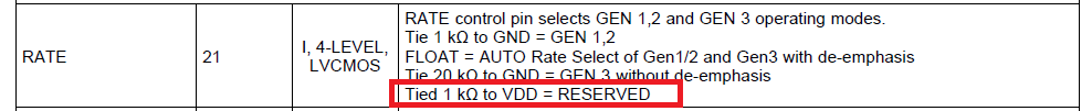

    1. In the EVK of the DS80PCI402 there is an option to set this pin to R mode (20K to GND) but in the data sheet ENSMB = R mode is not mentioned (only ENSMB=0 or ENSMB=1) do I need to support this option
    2. Regarding Rate pin:
    When its without DEM control does it means that in this mode (RATE=R) the Deemphasis dip switch changes don’t effect at all.

    1. The ENSMB pin only uses 3 levels.  0 = pin control, Float = EEPROM configuration, and 1 = SMBus Control.  Once the EEPROM configuration is complete, the DS80PCI402 will also accept SMBus register read/write commands.
    2. I do not recommend to use without DEM control.  In some cases the signal is optimized with a slight amount of DEM included.  Either -1.5dB or -3.5dB.  I would not recommend exceeding -3.5dB in a PCIe application.
    The RATE pin = R should not allow DEM changes to be present on the output.  I would not recommend to use this setting for the reason in #2 above.

    2. Do need to support the forth level option ( ‘1’ = 1K to VDD) for the RATE pin (it supported in the EVK and is RESERVED according to the datasheet)

    The "Reserved" options are not needed in regular systems.  The EVK was just built to include all the options.
