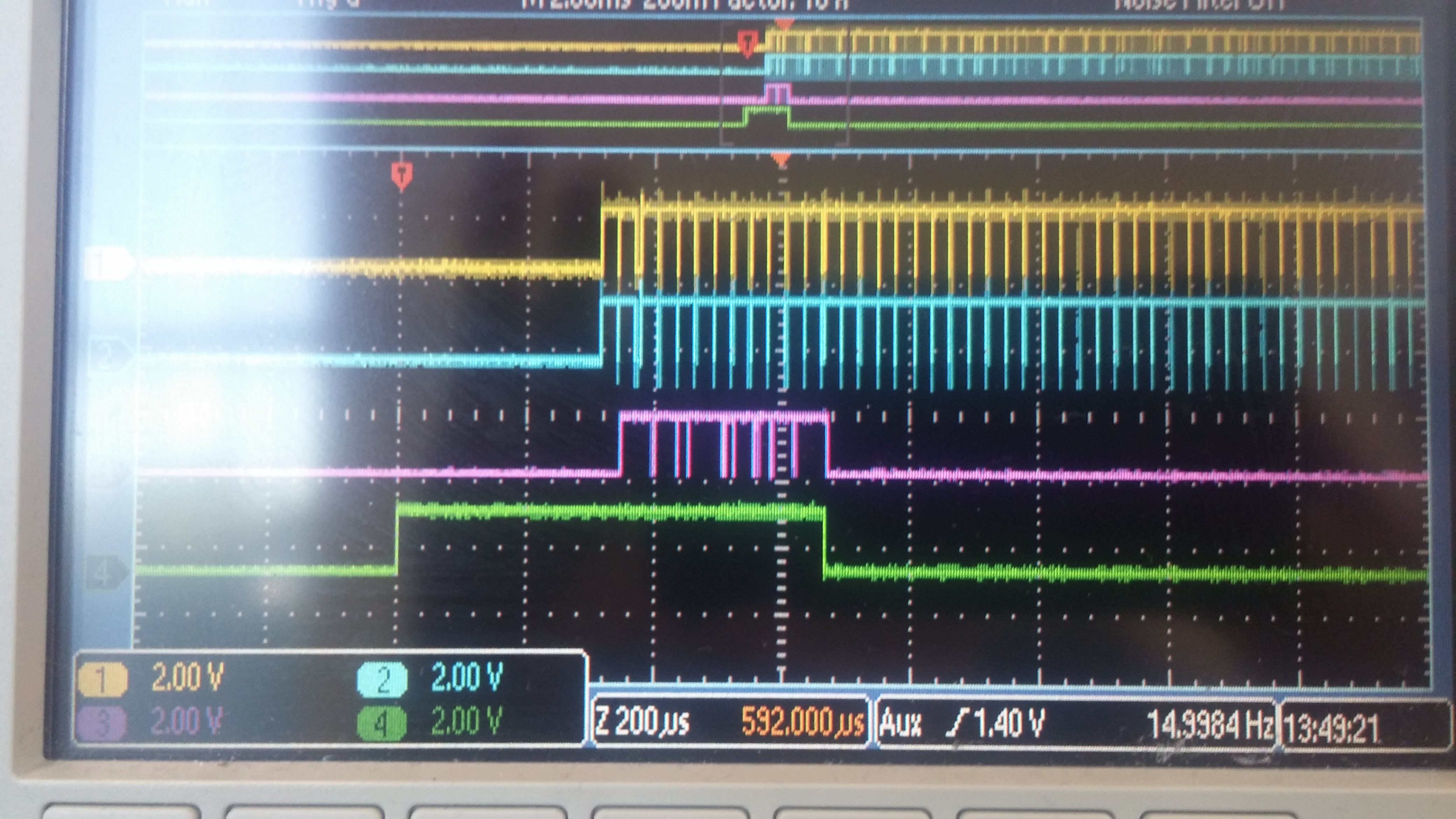

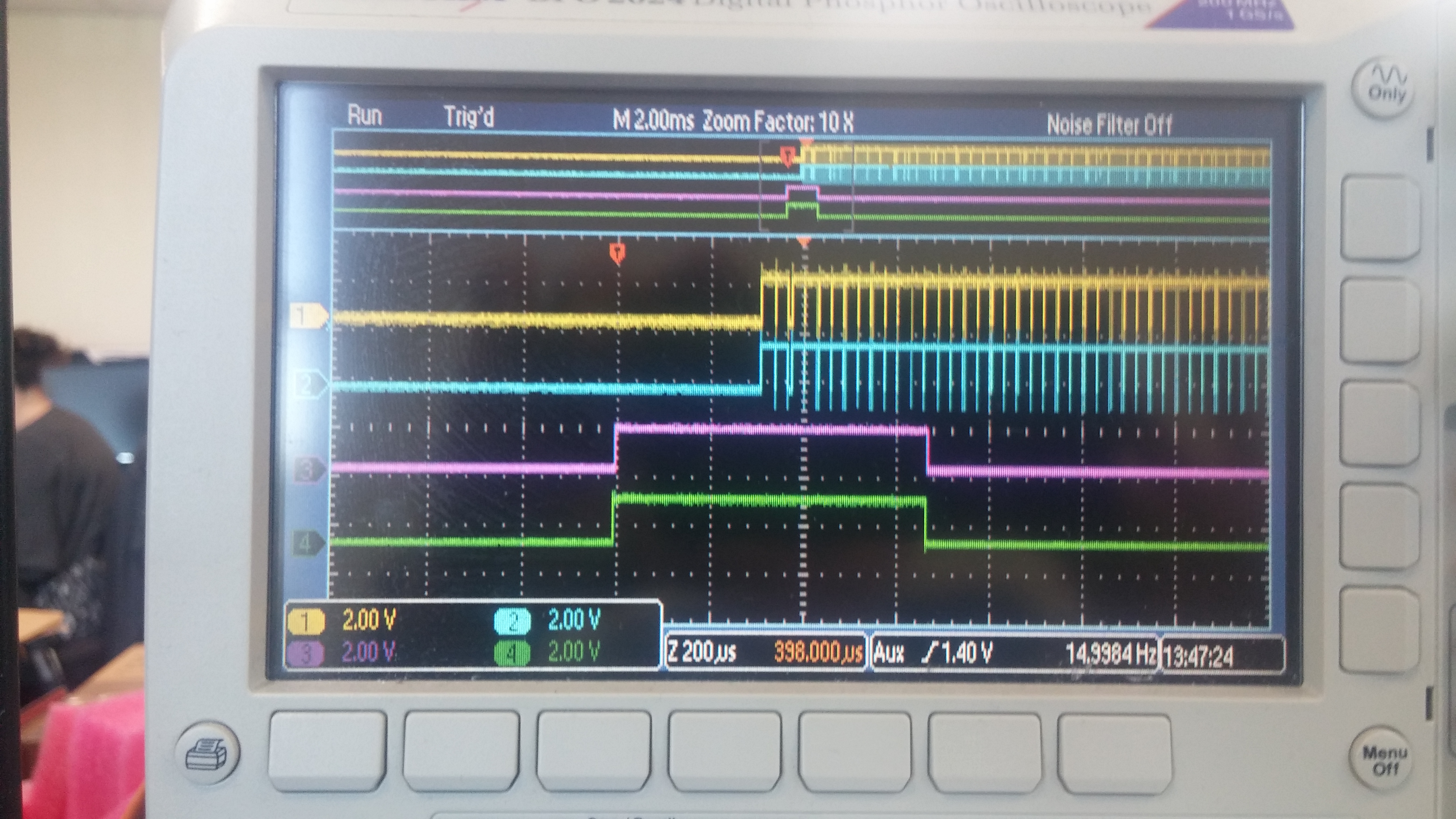

  • Took more scope screen grabs with GPIO set as follows
    board.WriteI2C (UB954,0x10,0xe5) # gpio0 rx0 line sync : yellow trace
    board.WriteI2C (UB954,0x11,0xe5) # gpio1 rx1 line sync : cyan trace
    board.WriteI2C (UB954,0x12,0x91) # gpio2 synchronous csi 2 transmitter   : green trace
    the purple trace in the first picture is the frame sync pulse
    ALL traces synced to sync pulse signal generated from DS90UB954 and output form the 2 DS90UB953 serialiser to the image processor chips
    You can clearly see that LV outputs are in sync and that the green trace [RX Ports synchronized, RX Port 0 synchronized with RX Port 1] is synced with the sync pulse.
    Why is this ?
    So the next picture shows the same signals except that purple is now the line valid output debug pin signal form a mipi to usb3 encoder device . Here the system is set for line concatenate with only port 0 or port 1 active in RX port forwarding control register.
    here we get the expected 1920 x 1080 yuv 422 8 bit output displayed on pc
    Now when we set both ports are active in RX port forwarding control register , we get the LV signals form the MIPI to USB3 chip terminate as the frame sync and CSI2 RX ports aligned signals go low.
    so does the CSI2 RX ports aligned output track with the frame sync pulse ?
