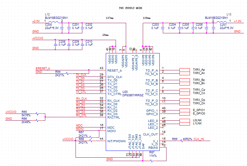

Good day! Can not get DP83867IR to 100 Mbps. It works only on 1000 Mbps. We can translate DP83867IR to 100 Mbps, but data exchange between DP83867IR and Zynq UltraScale + does not work.

  • more precisely there is no exchange between the PC and the DP83867IR. WE 7499110122 socket
  • Hi Andrej,
    By PC, do you mean link partner that is connected to DP83867 via cat 5e cable?
    How to you put the PHY in 100Mbps mode? Do you force it to 100Mbps or let it autonegotiate?
    Does the link partner support 100Mbps operation? Does the PHY have a successful link up? You can check this by reading register 0x0001 or by observing LED_0.
    -Regards
    Aniruddha
  • We connect to the R & H device, and the connection is established at 100 Mbps, and when connected via the D-link DGS-1008D switchboard, only 1000 Mbps works, even if we forcibly installed 100 Mbps, there is no connection to the switch.
