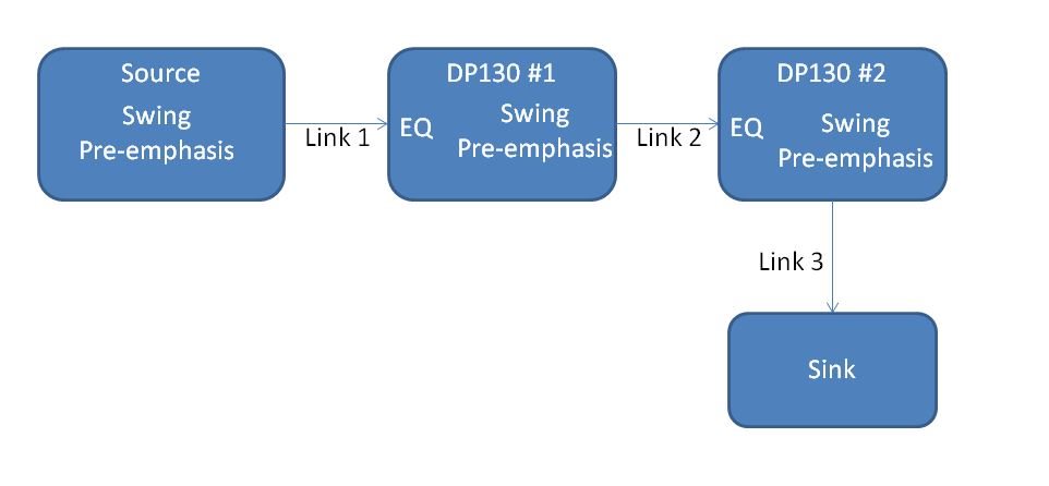

  • Ice
    Please see the block diagram. The DP130 is a limited re-driver which means it has its own SWING and Pre-emphasis level. The actual DP130 SWING voltage and Pre-emphasis is different from the Source SWING voltage and Pre-emphasis. During the link training, the Sink would request Pre-emphasis and voltage SWING level based upon the output of the DP130 #2 (Link 3), not the DP Source (Link 1). Both DP130 #1, DP130 #2 and the Source would adjust its EQ, Pre-emphasis and voltage SWING accordingly based upon this request from the Sink. While the DP130 #2 SWING and Pre-emphasis level may be ideal for Link 3, the same SWING and Pre-emphasis level may not be ideal for Link 1 and 2 since Link 1, 2, and 3 will have different loss.
    To overcome this, you need to disable link training in both DP130 #1 and #2. The EQ of DP130 #1 will be manually set to compensate the loss of Link 1. The DP130 #1 SWING/Pre-emphasis and DP130 #2 EQ will be manually set to compensate the loss of Link 2. The DP130 #2 SWING/Pre-emphasis will be manually set to compensate the loss of Link 3.
    With Link Training being disabled, the link bandwidth and lane count must be set. The link bandwidth can be set to 5.4G, but it will still support lower data rate.
    David

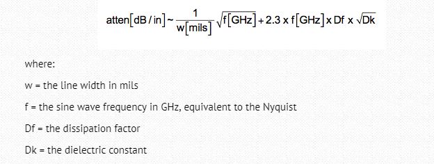

    You can measure the insertion loss of each link, or you can estimate the loss/in of each link using this formula.
