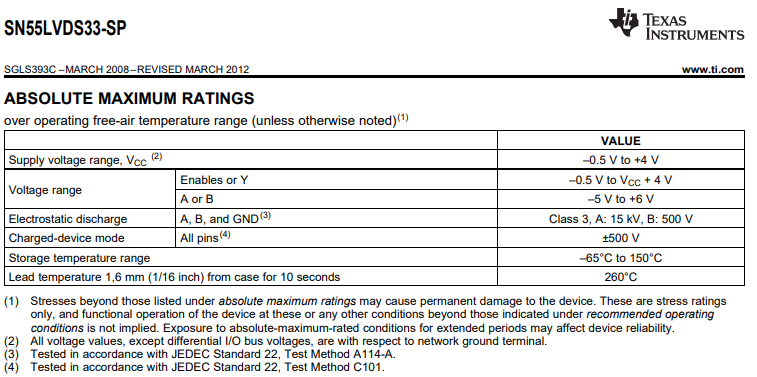

Part Number: SN55LVDS33-SP
Could you provide me with the ESD status (CDM, MM, and HBM) for 5962-0724801VFA and 5962-9762101VFA?

The engineer supporting this device is out of the office until Monday 7/29. I will see if I can track down this information in his absence.
Christian
Page 4 of the datasheet for 5962-0724801VGA has ESD information (doc#SGLS393C-MARCH2008-REVISED MARCH 2012). Since machine model information is not included it indicates this testing was not done.
For device 5962-9762101VFA, the cover page of the datasheet indicates "• Bus-Terminal ESD Protection Exceeds 8 kV". Our QML database shows an HBM of 4KV for the entire device. Since no CDM or MM data is available, it indicates this testing was not done.
