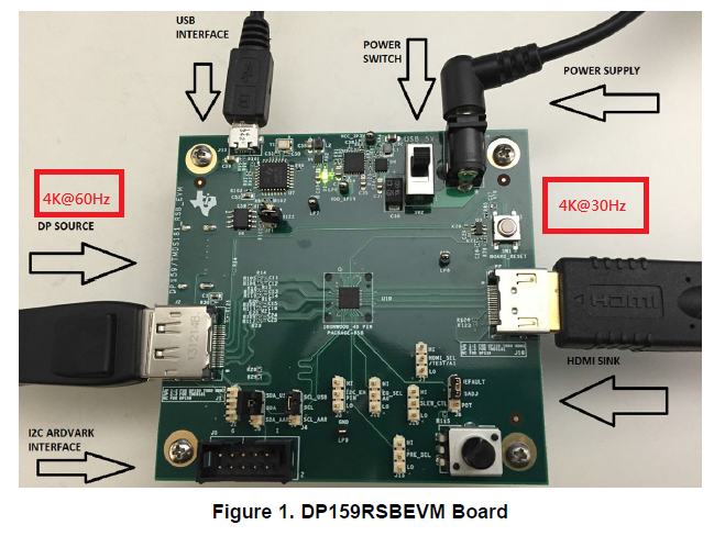

Dear,
We make sure DP Source was can support  4K@60Hz , but connect DP159RSBEVM and we find HDIM signal only can support 4K@30Hz
How to setting EVM? or this is IC limite condiction, like Displayport Dual-Mode v1.1?
If any suggestion, Please advise me.

    DP159RSB has no TX-TERM_CTRL pin. Could we set this pin through I2C?
    Information correct, DP++ is implemented in our current System.
    By connecting DP++ (Output Resolution 4K @60Hz) to DP159RSB EVB, than output HDMI to monitor, the monitor shows the resolution 4K @30Hz.
    Johnny

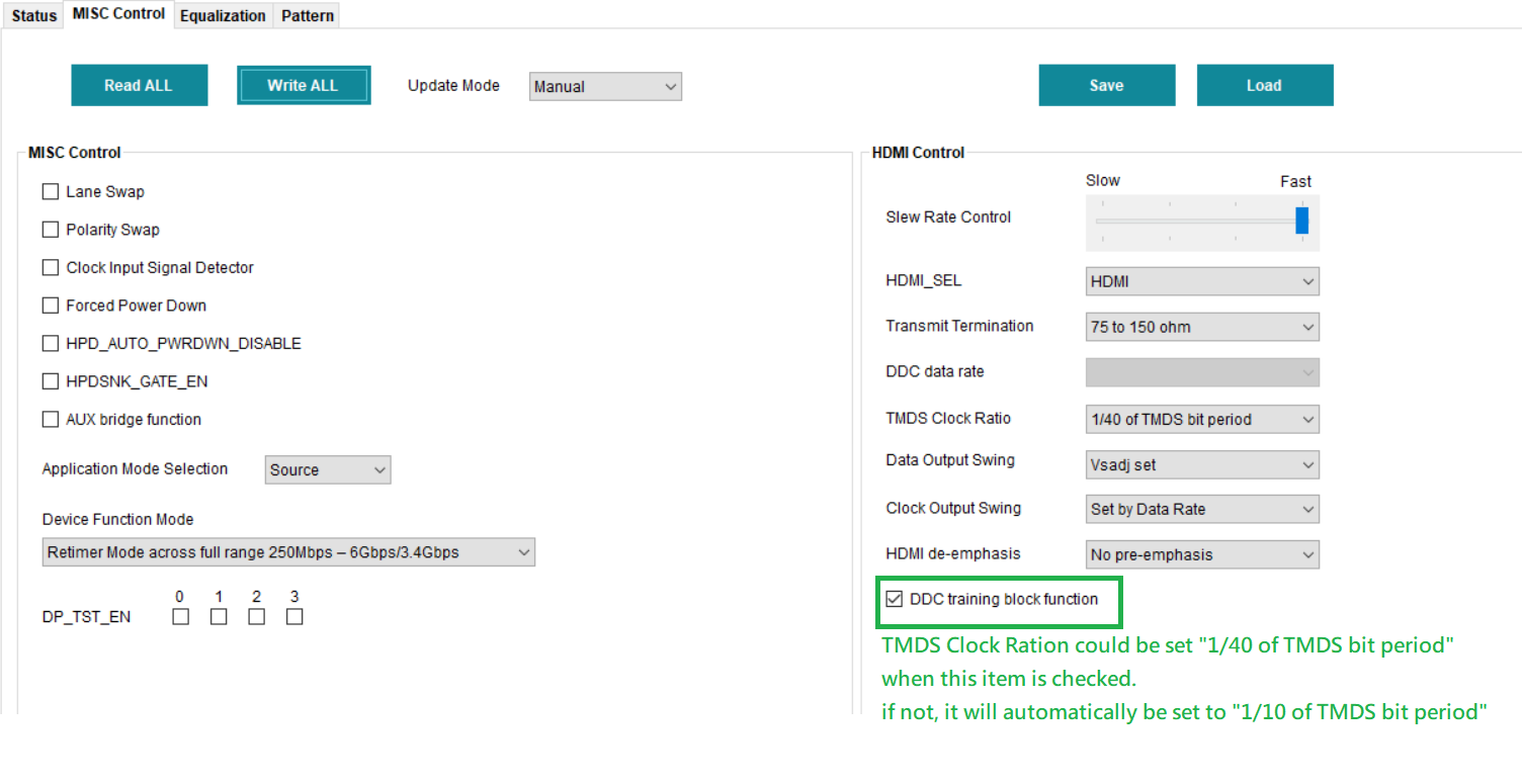

  • David,
    The register as above pics. I dump this register by using TI "EyeScan Tool"
    When we set TMDS Clock Ratio to "1/40 of TMDS bit period", the monitor will have no output.
    We tried to measure HDMI clock from DP159RSB EVM. the clock is around 75MHz.
    After we change the TMDS clock Ratio back to 1/10 of TMDS bit period, the monitor has output (4K @30H), the clock is 296MHz.
    Johnny
  • Johnny
    If you don't force write the DDC_TRAING_SET bit and let TMDS_CLOCK_RATIO_STATUS bit be set from the DDC snoop, can you please dump out the register one more time?
