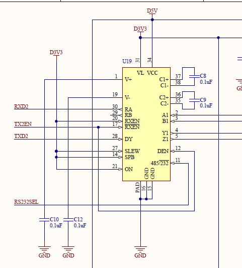

My customer see below SCH from others and find a device without name in SCH which combines 232 with 485 function.
Do we have this device or like that?

Hi Eggsy,
We do not currently have such a device, although it is possible to achieve this function with separate RS-232 and RS-485 devices. You can find an example reference here:
http://www.ti.com/tool/TIDA-00540
