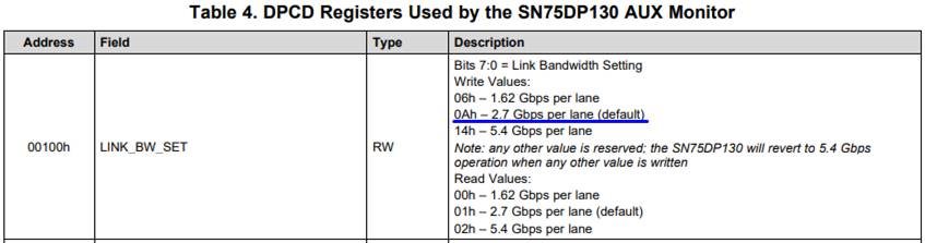

Our DisplayPort (source) using the SN75DP130 with link training returns an HBR (2.7 Gbps/lane) link rate and we are suspecting the redriver LINK_BW_SET default has something to with this.
Our Intel GPU supports HBR2 (5.4 Gbps/lane) so we expect it to use the HBR2 link rate on the DisplayPort with the redriver.
Is there a way we could change the LINK_BW_SET default to 14h – 5.4 Gbps/lane? Or is there a way we could let the redriver choose that bandwidth during link training? (Our sink and cables support HBR2 as well)
Screenshot below is taken from http://www.ti.com/lit/ds/symlink/sn75dp130.pdf p21
Looking forward to your response.
 THanks!
Alfred
  • Alfred
    If the Link Training is enabled, the LINK_BW_SET will be set based on the AUX snooping. They can disable link training, and indirectly access the DPCD address space through the local I2C registers.
    It is possible that the link training failed at HBR2, and the source adjust the bandwidth from HBR2 down to HBR.
