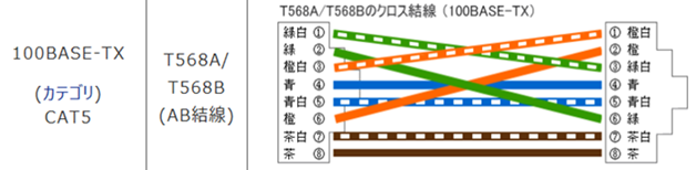

    New information, This issue was occurred when they use cross cable as below,
    DP83867 detected as 1000base when they connected this cable. (it is no issue, if DP83867 will detect 100base)

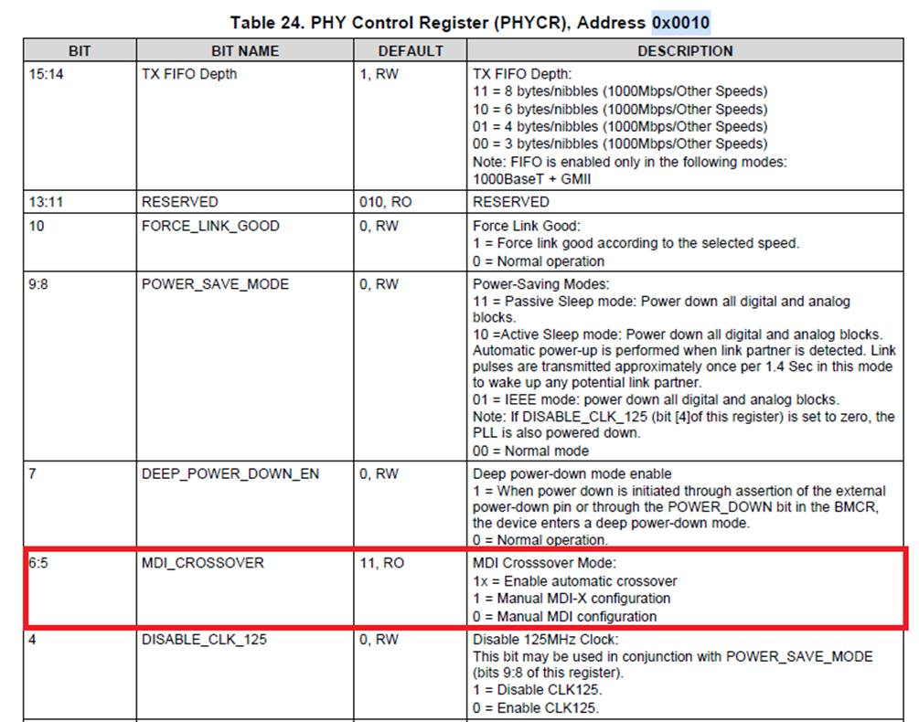

    I found following register information in Address 0x0010(PHYCR)
    Regarding MDI crossover setting, They set 0x4000 for this register. I think, the Automatic crossover is disabled.
    Also, customer have some questions about this register.
    Is it  RO(read only) register? If yes, Customer cannot write this register, right?
    If customer can change this register value,
    - In case of they set bit6=1, bit5 is no care. Is it correct?
    - Can DP83867 detect 100base even if they use T568A/T568B cable by setting this register?
    - When should they set this register? Boot loader start timing? or OS start timing?
    Muk
  • Hi Muk,
    Register 0x10 is read write so customer should be able to change the settings. From my previous post, I would say keep the value of register 0x10 as 0x5048. T568A/T568B should both be ok. There is not specific time when this register needs to be programmed. I would just recommend checking the software code to see if some part of the code is changing register 0x09 and 0x10.
