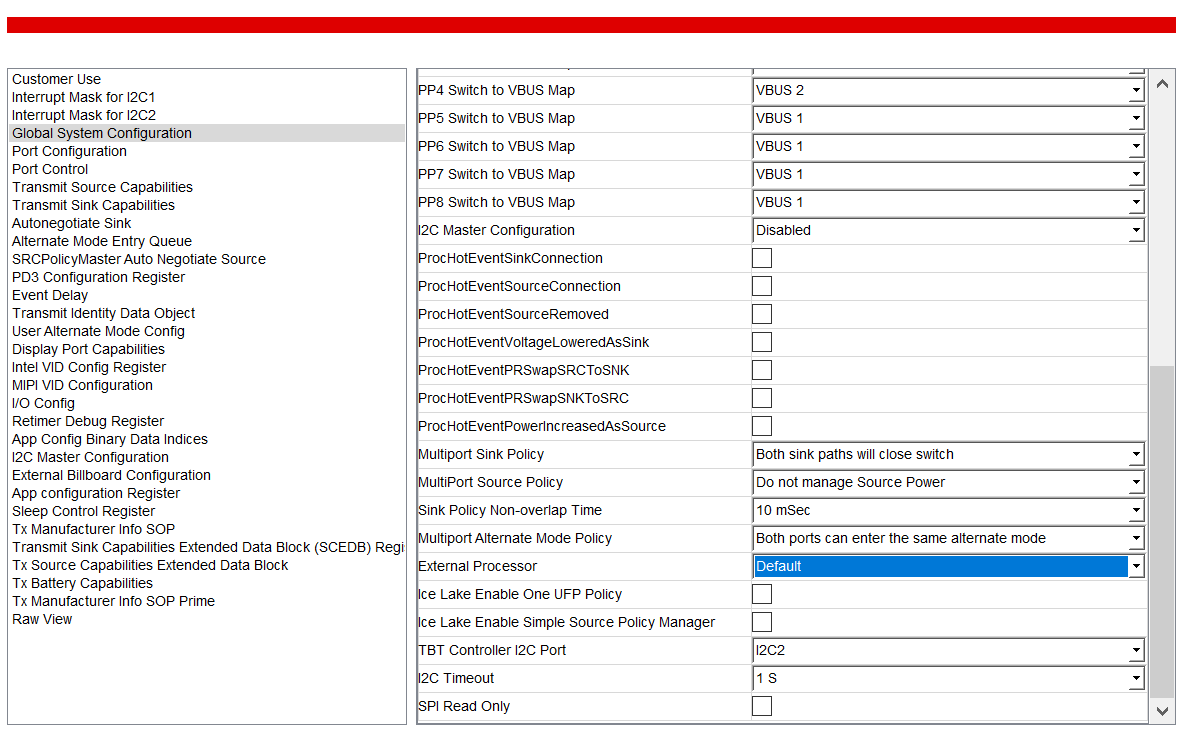

Can the TPS65987D set the HPD delay? What is the meaning of the Ice Lake HPD delay in the software interface? Is it the interface to set the HPD delay?

Hi Peggie,
Are you using an Ice Lake system? If no, these field can be ignored as they will no alter the HPD behavior for a normal application. If yes, do not change these values.
Make sure you do not have the External Processor = Ice Lake when not using this in Global System Configuration. Check below.
