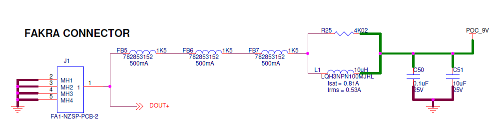

We have interfaced Snapdragon 820 to OV2311 over TI FPD Link 3 based SerDes (DS90UB953-DS90UB960) and we are facing issue in the captured preview as attached. We see blue yellow lines that become more prominent,the darker the capturing (room) environment becomes.
We suspected noise introduced due to SerDes or timing issue in programming SerDes. But when we enabled sensor test patterns, we are not observing these lines.
When OV2311 is interfaced directly over MiPi CSI, for the same configurations for sensor and 820, we don't see this issue. Basically there is no change between direct MiPi CSI and over SerDes, except SerDes configurations at init time.
SInce there is PoC in our design so our first suspect was that, tried isolating power and data lines but still no conclusion. Attached snapshot of POC filter also, please let me know for your suggestions.
Please provide some input on the attached noise. What could be the source of it?
  • Hi Shubham,
    The PoC network looks good to me.

    From the registers/values you provided, there's no parity/back channel errors detected, which means there's no issues with the link itself. The 953 is detecting CSI errors from its CSI receiver. How's the layout of your board on the CSI input side (impedance, skew matching, crosstalk, etc.)? It might also be worth it for you to consult the imager manufacturer about this.
