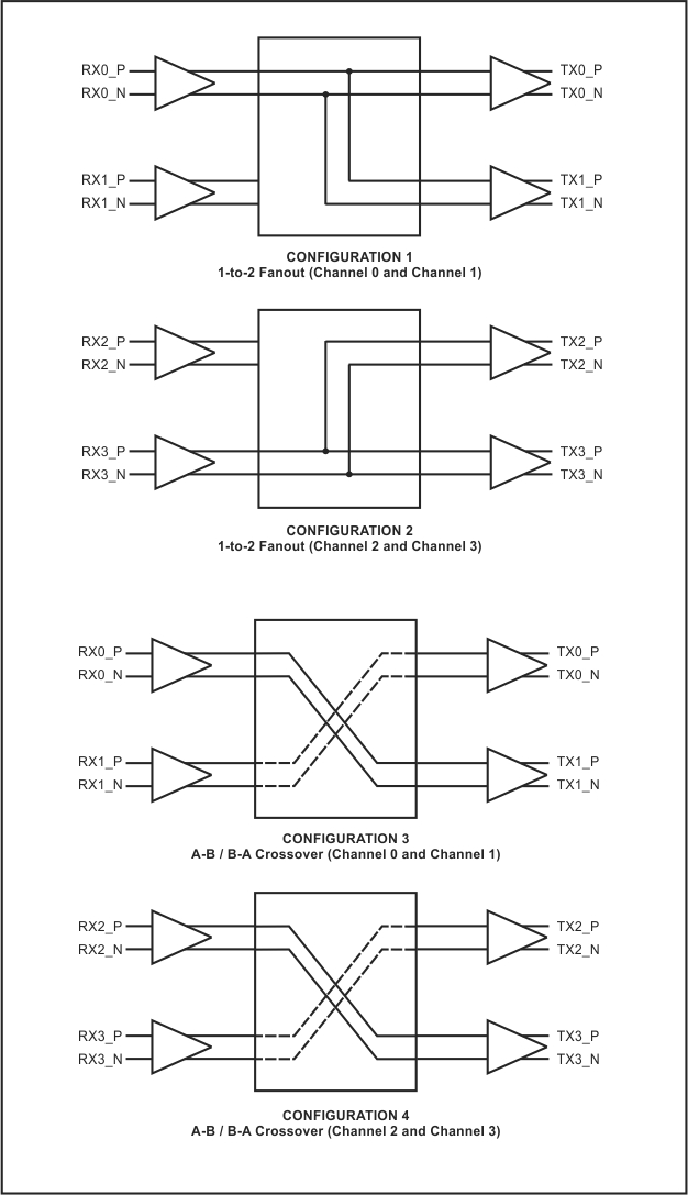

  • Lee:
    Thank you again for your recommendations, I greatly appreciate it.  The DS250DF230 is a wonderful part, but my thoughts of the cross-point switch functionality cannot provide a loopback.  The 2x2 cross-point switch provides a 1-2 fanout or a A-B / B-A crossover per the figures below.  I hope I am wrong, but please comment.
    If the device is routed in the system to support upstream and downstream channels, the 1:2 function or the crossover function would perform a loopback.  Depending on the channel connections, the loopback could be implemented on either upstream or downstream signals.
    Lee
  • Lee:
    Thank you for your recommendations again.  Unfortunately, our new product does not support routing to provide loopback.
