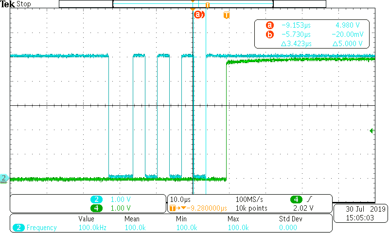

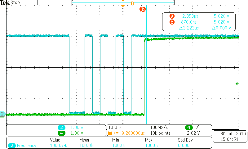

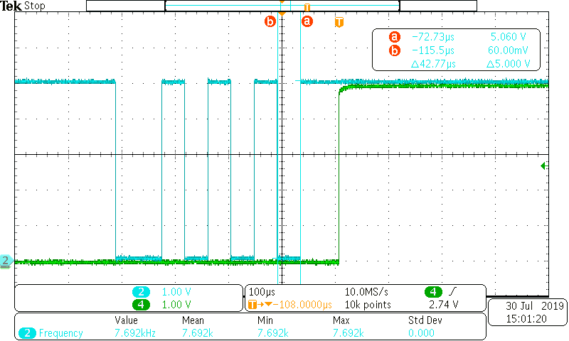

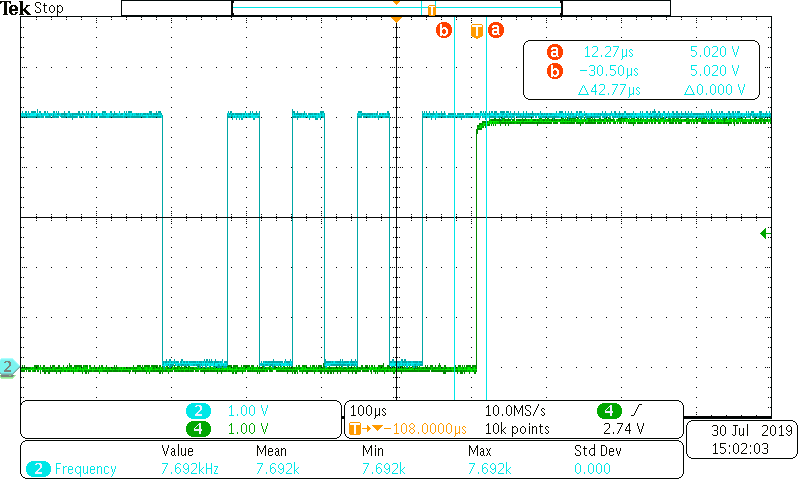

  • Hello Kaede-san,
    I just finished making measurements and here is what I found.
    I sent 0xAA and measured the low time for a slower baud rate and measured 42.77us:
    From this I shifted cursor B to ~42.77us from cursor A to measure the stop bit (only 1 stop bit). I then shifted cursor A ~42.77us from where cursor B was and looked to see if we were below 42.77us.
    From this, we can see the INT triggers in the microsecond range and is below the 1 baudrate max we spec.
    I repeated this at a higher baud rate as well:
    From this I would say that our device actually does trigger it's INT based on the baudrate and that it should always be less than 1 baudrate. It does NOT have a sub 100ns asynchronous max time like the B version.
