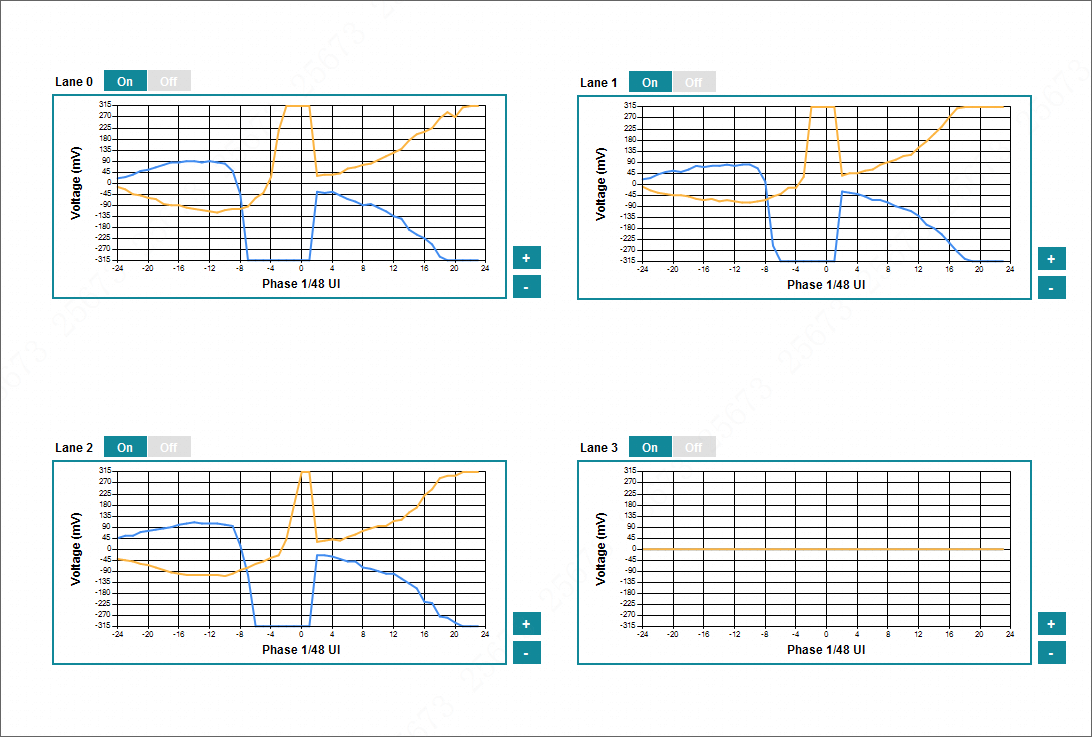

HDMI signal tested with TMDS181_DEMO EVB using EysScan Tool.
configuration as follows:
Input signal:
How can I evaluate the eye pattern? thanks!

The eye diagram looks OK.
David
Piero
There is an issue with the EyeScan SW on how it interprets the eye at HDMI2.0 and it is documented in the TMDS181 EVM user guide: http://www.ti.com/lit/ug/sllu228a/sllu228a.pdf.
But from eye height perspective, lane 1 performance is not as good as lane 0 and 2.
