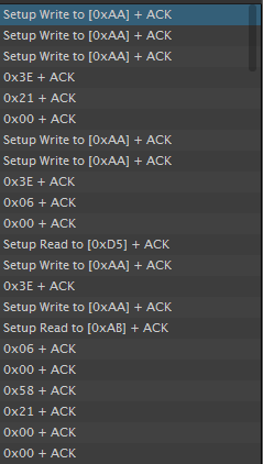

    Furthermore, although we were able to verify that we were able to send signal to CH0, we were not able to read the correct Fuel gauge data. When writing and reading the I2C slave at CH0, do we need to follow any I2C Mux protocol? For example, in reading the CHEM ID of the  fuel gauge without using the I2C MUX, our protocol includes:
    1. I2C write to 0xAA(Fuel Gauge I2C Slave Address with Write bit): 0x3E2100
    2. I2C Write to 0xAA (Fuel Gauge I2C Slave Address with Write bit): 0x3E0600
    3. I2C Read from 0xAB (Fuel Gauge I2C Slave Address with Read bit): 0x3E
    Since we are using I2C MUX, should we append 0xAA before we issue our commands? Are there any protocols we should follow or any I2C MUX register we should manipulate before sending data to the Fuel Gauge at CH0?

    You should provide an o-scope shot of the I2C read from '0xAB'. With this we would be able to tell if the I2C transaction is correct (Do pull ups look okay, signal integrity in tack? VoLs look okay? Any unexpected non monotonic behavior? Oscillations in the signal? Undershoots which can break devices? Overshoots which can break devices? I2C pull up voltages losing regulation? There is A LOT that an oscope shot can show which a logic analyzer does not show.), or if the battery gauge requires extra steps inorder to properly read.
    My guess here is that you are only reading one byte of data when you need to read 3 bytes. Essentially your I2C master doesn't ACK to the slave to tell it to read further bytes.
    You may also need to resend the command byte to reset the pointer for the battery gauge to the correct address as I assume it uses an auto increment function. I can assign one of the battery gauge Applications Engineers to this thread to help trouble shoot this as I specialize in the I2C MUX device and not the BQ devices.
    "Since we are using I2C MUX, should we append 0xAA before we issue our commands? re there any protocols we should follow or any I2C MUX register we should manipulate before sending data to the Fuel Gauge at CH0?"
    No, if the channel is enabled then the I2C MUX's job is done. You now just need to figure out the correct way to talk to the fuel Gauge.

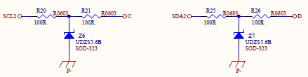

    The rise times on the clock lines for both the slave and master seem to be slow, I would recommend changing the pull up resistors to a lower value as of right now, we are likely violating the rise time limit defined by the I2C/SMbus spec. Your power point looks like you are using 4.7k pull ups, we may want o try 2ks or even 1ks for clock and data.
    You may also want to get rid of the 22 ohm series resistor as that is shifting up the VoL on your signals.

    The Ch3 and Ch5 are the clock lines before and after the I2C Mux. The pull ups were changed to 1.3K as well.
    Regarding the schematic of the battery with the fuel gauge, I can only show a portion of it here as we have an NDA with the company who designed the battery packs. These are the limiting resistors used for the fuel gauge:

    Just for clarity, can you confirm my understanding of the I2C bus is correct? (If anything at all is wrong, please point it out) If the pink probe is correct, it would be best to probe to the right of R26 directly at the Bq device.
    Where Rx sits can make a difference (if its to the left of R25 or to the right of R26).
