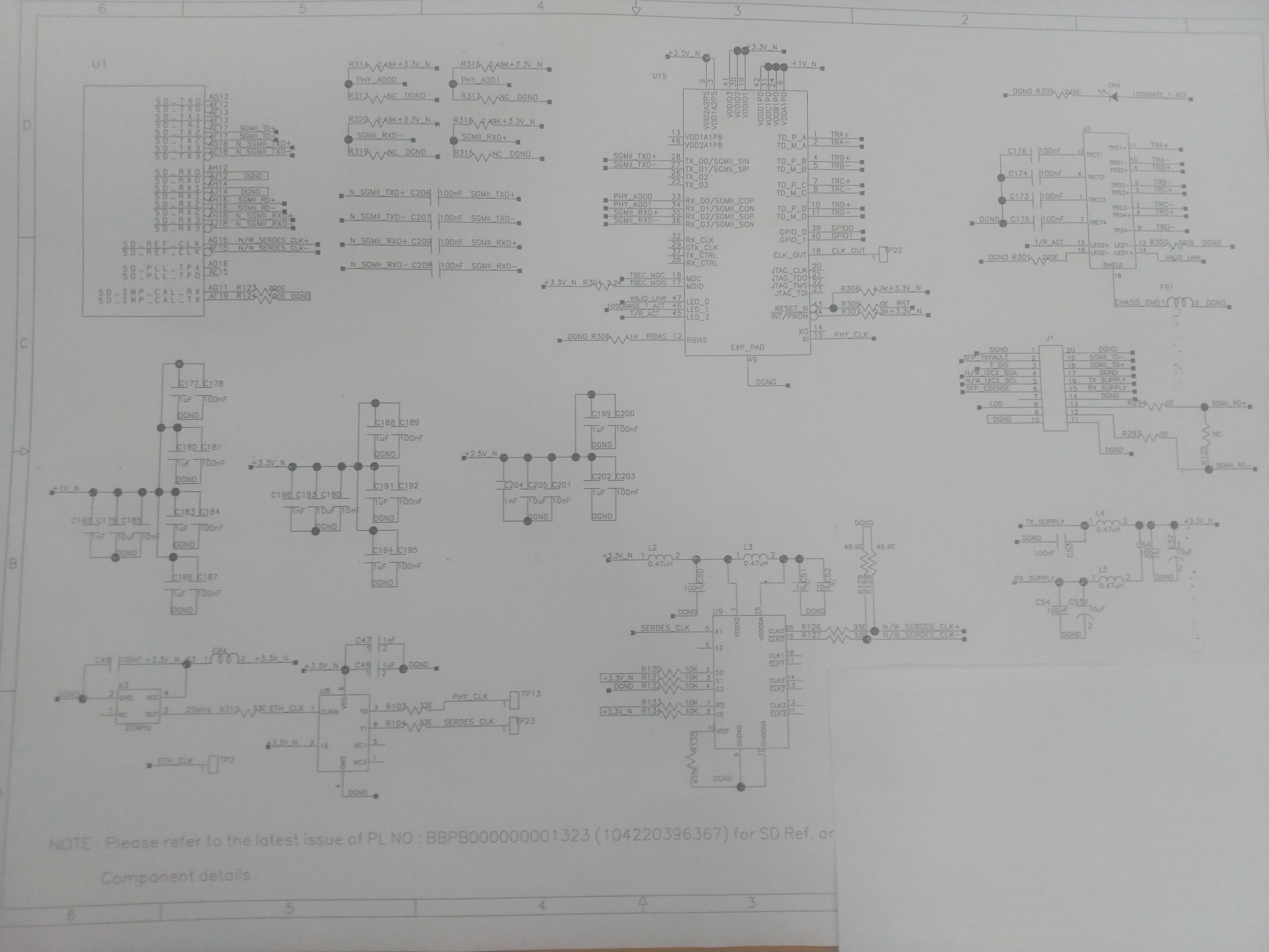

DP83867IS: powerup sequencing problem in 2 supply mode
Part Number: DP83867IS

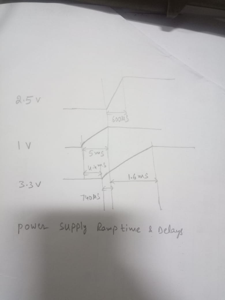

As per datasheet For DP83867 in 2 supply mode power sequencing is not required ans same thing we have followed.Power will be applied to the device like this
1V--->3.3V---->2.5V.
If i give 2.5V---> 1V----->3.3V,then it is working.
Please clarify us what is wrong.
