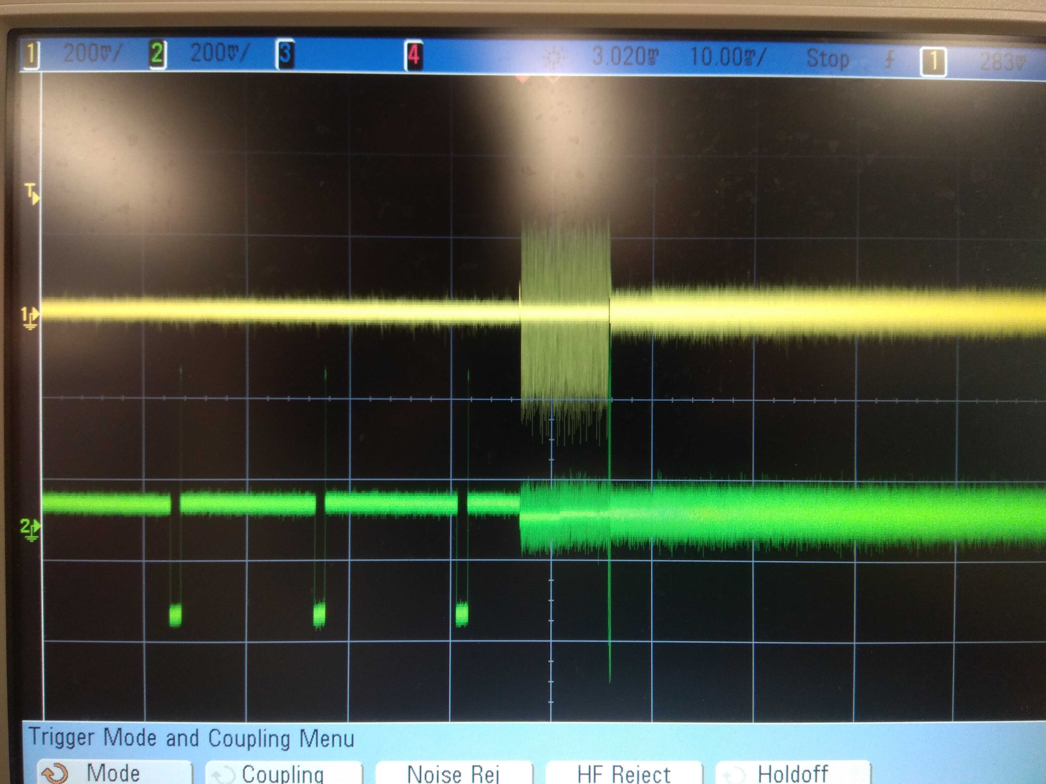

  • Without replacing the AC caps with 50ohm resistors, the TUSB7340 TX waveform is yellow and RX waveform is green. Correct me if I am wrong, I feel like it passes initial LFPS handshake and fails in link training.
  • It looks the the host and the device are getting out of sync during power on and one side is going to compliance mode.  The green signals look like Polling.LFPS (can you confirm the time base in the scope shot?), but the TUSB7340 has not started polling yet.  Since adding 50 ohm resistors impacts the behavior it is likely an issue with the receiver termination detect where the device is detecting the disabled terminations of the TUSB7340 as enabled.
    Can you provide a scope plot from 1-2 minutes after a device fails to enumerate?
  • The time base is 10ms/div.
    Could you elaborate this "Since adding 50 ohm resistors impacts the behavior it is likely an issue with the receiver termination detect where the device is detecting the disabled terminations of the TUSB7340 as enabled."?
    We will try to collect waveform 1-2min after the device fails t enumerate.
    What other things we can do to further debug whether it's a out of sync issue and something else?
  • That is very strange, the LFPS.polling should be 10 us,  not10 ms.
    Please provide more scope plots.  Can you issue a software reset to see if it fixes the issue - sometimes this can be done by disabling and enabling the driver in Device Manager.

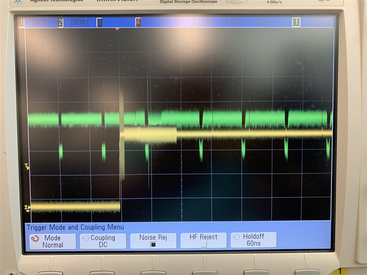

  • Hi JMMN,
    We also bought a TI tusb7340evm board. It works well. Below is its waveform for your reference. The main difference is after it goes into the high frequecy signaling, it stays there.
    Regarding your question, what our problematic borad's waveform looks like after 2min, it looks like below
    And regarding the software reset, it does not help.
