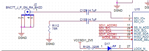

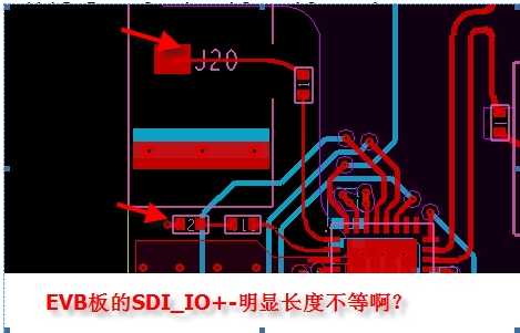

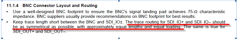

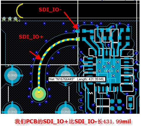

Hi Sir
Now the eye diagram of the prototype test is not very good. Under 12G, it often loses lock. We need to do the simulation of the signal integrity of the PCB to see if there is a problem with the PCB design.
could you help provide the model of IBIS-AMI or hspice for me, tks!
