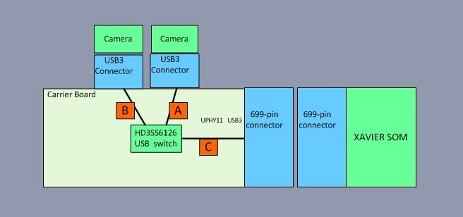

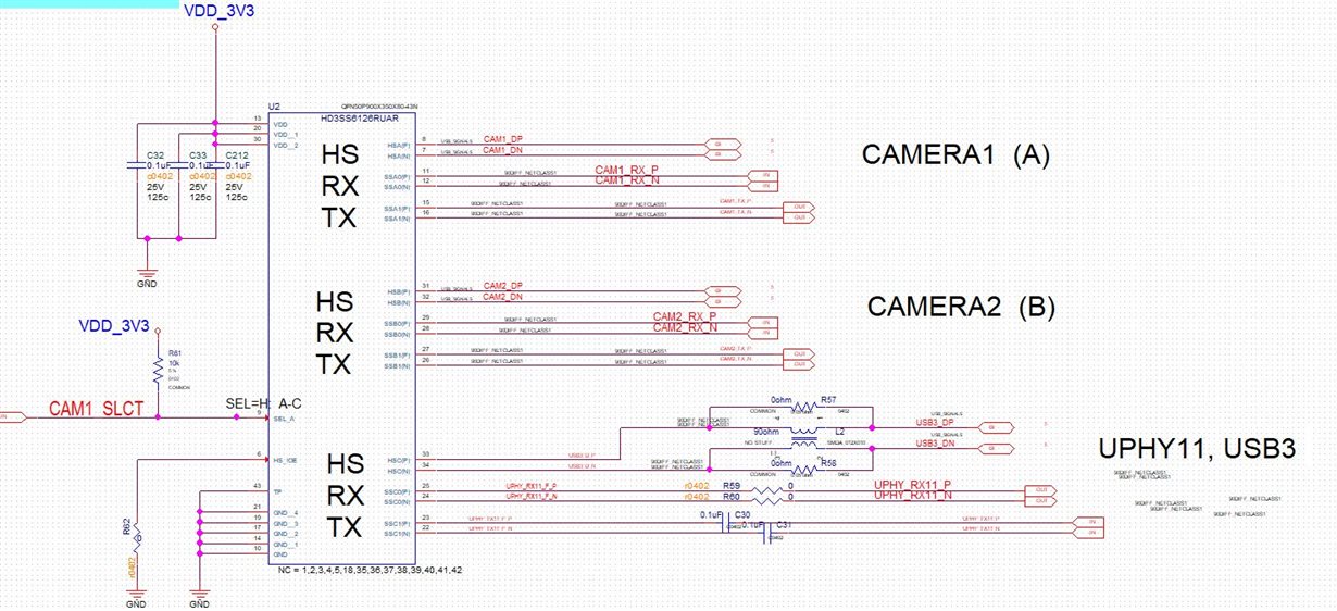

I'm going to connect a host (NVidia Xavier) through HD3SS6126 to two USB3 devices.
In the datasheet, it is mentioned that "All of the interfaces the HD3SS6126 device supports require AC coupling between the transmitter and receiver",  and later-on in that paragraph (8.2.2.2) it says: " The placement should be along the TX pairs on the system board..."
I don't understand this last sentence.
Please see the schematic I've prepared, and inform if need to move the coupling to channels A and B.
