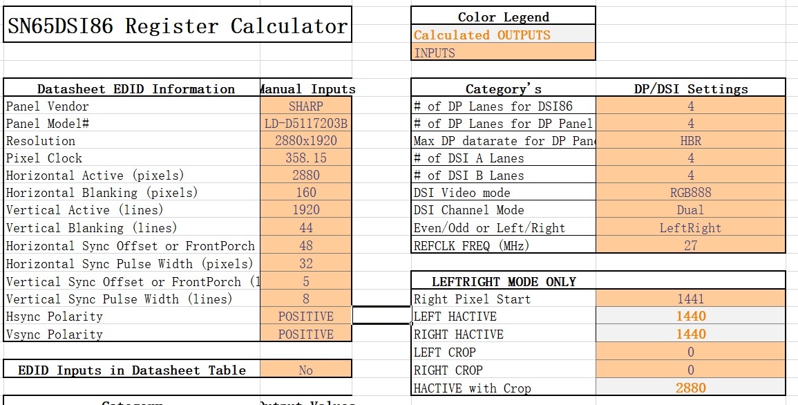

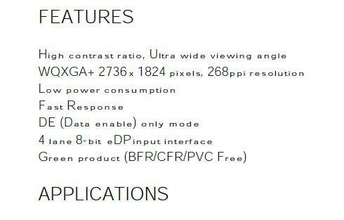

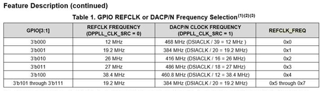

We had new Panel as below( 2736*1824*24bpp*60fps), Does DSI86 support it?

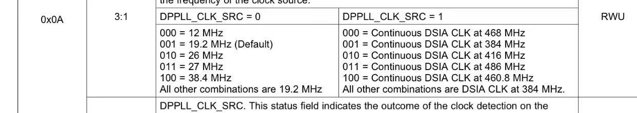

We DSIA_CLK is 520MHz, I saw the SPEC don't have this Freq.
If we use REFCLK which one Freq can for this Panel
If we use DACP/N CLK, how to chose it?
