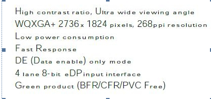

Could SN65DSI86 be used Qualcomm platform MSM8996? There is one customer who need to confirm this question.

DSI86 supports Qualcomm MSM8996. But we also need to check to make sure the resolution of the panel that is being connected to DSI86.

Please see this app note: http://www.ti.com/lit/an/slla425/slla425.pdf.
You would need to calculate the minimum DSI lane and frequency base on the panel information.
