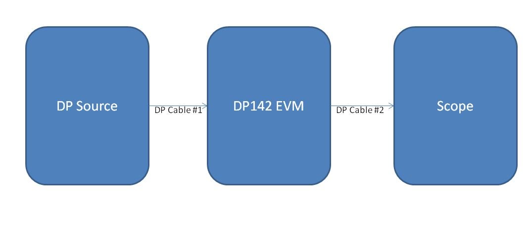

my customer wants to use this part but is asking for DP compliance data from our side?
They are seeing some issues and want to compare it.

Attached is the DP142 DP compliance report. But the DP compliance is system dependent, what issues are they seeing?

Where is the retimer sitting? is this the EVM compliance data? How long was the used cable?

DP142 is a linear re-driver, not a re-timer, so there is only equalizer to be tuned.
The data was collected on the DP142 using a standard DP cable.

thanks for your support! Please help me understand the following points:
Is cable length not important?
Can you describe the test setup a little more?
Just for my understanding:
Are these the compliance measurements of the EVM or from what setup? As you said, the measurements are dependent on the system, I wonder what system we measured on.
