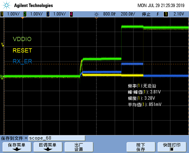

My customer uses this device and found that the frequency of RX_CLK changed to 6.94MHz, not 2.5MHz, the crystal frequency is 25MHz. What may cause this? The PHY works on RGMII mode, Thanks.
Hi Geet,
NO. We can only read register data through MDC / MDIO interface. Below is the power up timing sequence I captured, I may need your support below,
Thanks.
Above has big glitch on VDDIO. Can you please ensure that VDDIO is ramped completely ?
Geet
YES. And I find that the power is the main cause to the PHY to get into an unnormal state, which can lead the clock frequency to ~7MHz. If I used external 3.3V, the issue is no longer exist. Do you have some idea about why the power can cause this issue? Thanks.
That's the requirement for the PHY specified in datasheet.
Geet
Hi Geet,
Could you please share me what is the requirement, on which page? And Why the clock frequency will be 6.94MHz?
Device is characterized as per the specification defined in datasheet. Power Ramp Timing are defined in Power on Reset section.
Behaviour of device operating out side the specification is not characterized and we can not comment why RX_CLK is 6.94 MHz.
